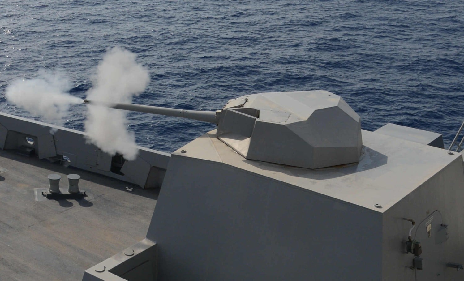

Since there's SİPER why should we do it?
There's a mere alternative for old frigates: Gökdeniz -ER.
PLAN modernized old frigates with HQ-10
Before
After
