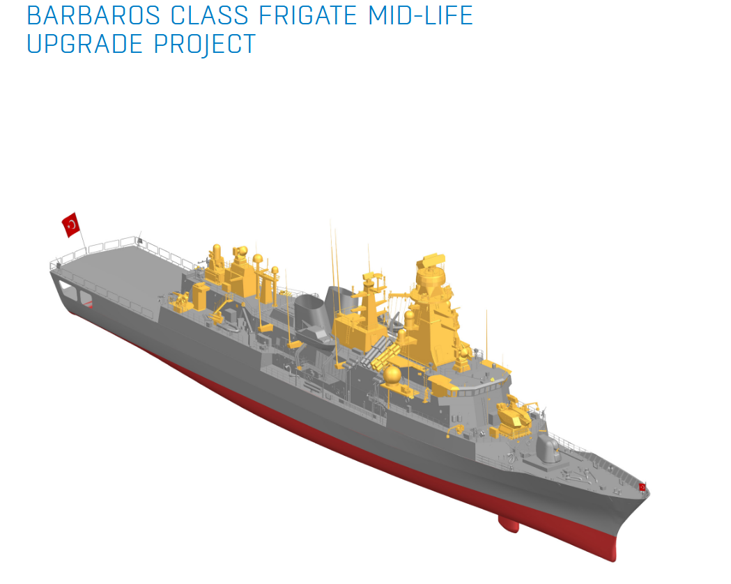

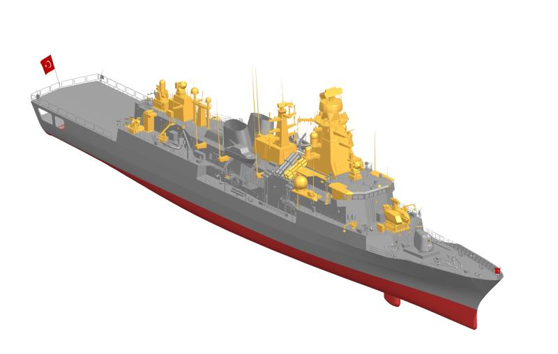

FYI, image has been changed to this, or i am not able to find the new document; earlier image used to be in this link:
But now instead we got this:
Also modified in the PDF document;
Any thoughts on why they are opting for 2 different kinds of CIWS? Seems like a weird choice to have 2 different gun based CIWS with comparable ranges.
I'd think 35mm air burst fired from Gökdeniz would be just enough. If I have a choice, I would rather fit a RAM launcher where Phalanx is, especially when those are already in use in TDK on Ada class. Else they could also wait out for Gökdeniz ER.

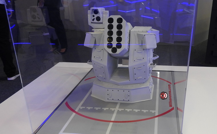

Gokdeniz and Phalanx aren’t the same. Gokdeniz has quite a bit more range. Gokdeniz has an effective range of 4 km. Phalanx has an effective range of 1.5km.
You may hit a supersonic anti ship missile travelling at 2-2.5mach with phalanx. But the debris will still cause serious damage to the ship due to the kinetic energy the pieces carry. Gokdeniz creates a wall of iron at 4km distance and from that distance the ship will not be adversely affected.
Our navy likes phalanx. We have them already on these ships. We don’t like throwing them away. It also creates a last level of defence.

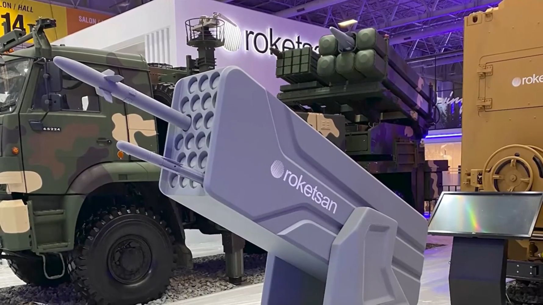

I agree with you about RAM in stead of Phalanx. But if you look in to it you will find that, there is an unpublicised embargo on the RAM systems too. They are also very expensive. Aselsan/Tubitak production Gokdeniz ER , or even better Roketsan’s Levent using Sungur-ER missiles will be a better and cheaper option.
When they are ready, they surely will find their way on to these ships.
Aselsan/Tubitak Gokdeniz ER.
Roketsan’s Levent
Roketsan’s Levent
Right... still, might as well just leave that space as is for now and wait for either Gökdeniz ER or Levent. Maybe TDK could later take that Phalanx off and put it on another, newly built ship that needs a CIWS, though I still think that'd be unnecessary added procedure than to just wait for Turkish missile-based CIWS. Especially considering recent price hikes for the Phalanx system.
Phalanx is being reused from the inventory, and the count is limited thus they thought of using it this way. If i remember correctly there are 4 or 6 units in the storage.
Still this may not be the final image, forward spot was already made to support Gokdeniz so it may receive Phalanx, but seems less likely.
Few reasons;
- Gokdeniz is heavier, this is an MLU thus the weight restrictions pushes them for Phalanx, the forward one was handled somehow but the aft position is higher and on top of hangar thus required additional jobs which was not feasible.
- Keeping budget low, purchasing new CIWS for an MLU, eventhough it can be scrapped later for use on another platform, may not be cost efficient. Thus, 2 x Gokdeniz was not feasible.
- US may not sell additional Phalanx, even doubting if the last batch of systems received an upgrade but it was reported as such. So, 2 x Phalanx per hull (4) is not quite possible.
- Gokdeniz ER - Levent may be operational, in best case, in 2025 - 2026. These ships are needed in service by that time.
- RAM is expensive, again US even didn't approve the sales for the spare missiles, earlier.

Yeah, the weight(and physical dimensions) was also another reason I've brought up RAM, since the Mk.49 GMLS have a comparable system mass compared to Phalanx. I was quite aware that Gökdeniz might be too heavy.
And those are some good points, too. So overall, it's more of a compromise, though a rather efficient one.

The final weight of Gokdeniz was not disclosed but without MAR-D 3D search radar, it should be about + 60% of Phalanx. Possibly since they have added an integrated mast on the ship already they have pushed the limits of stability and growth space of the original design, thus it made sense that way. Few tonnes usually does not matter to us, but when it is an MLU at this scale, it does.
