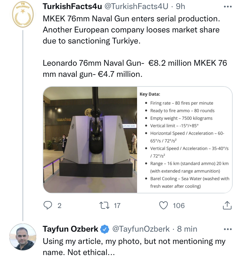

What he posted was actually true; it is just that he didnt mention the source and this is called palgiarism which is quite an unproffessional behaviour
Well he is a joke period. According to him Turkey right now was producing the SU-57 and SU-35 with Turkish avionics and armaments, had bought the J-20 from China, JF-17 with Turkish avionics and armaments from Pakistan. And this is just the tip of the shitberg is spreads on Twitter.
I know. What I wanted to show through my post is that in addition to post nonsense, he also plagiarizes other.
