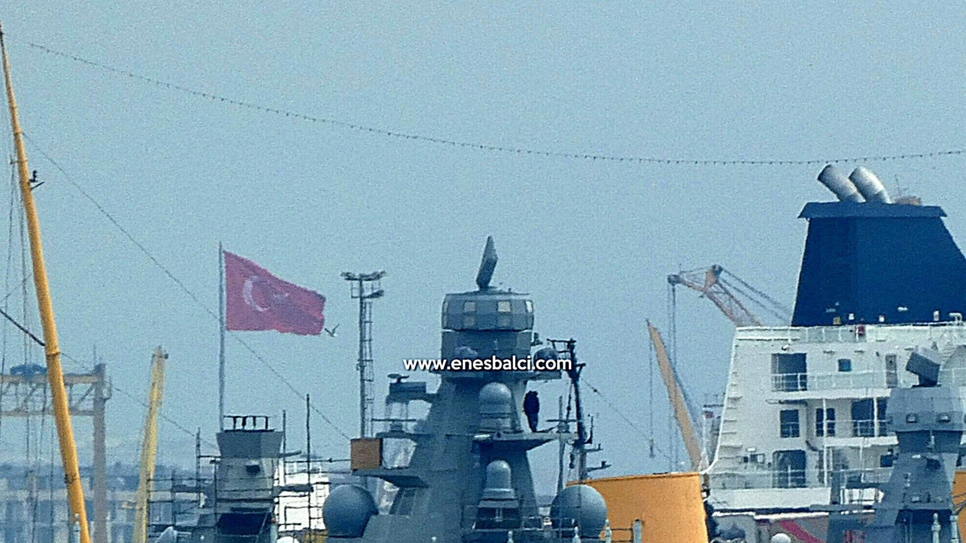

Is chenk-S a multi-function radar?
Can it provide fire control?
@Anmdt @TheInsider
ARDA is probably an X-band radar with 1000 maybe 2000 GaN modules. It will probably be mounted on Turk Type FAC.
Very very slim. Just shows how far Aselsan has come. Can't wait for Arda next year and Cafrad in 2026.
Arda will be an interesting one, coming with fixed face version and two different sizes. It will complement CENK.
@Anmdt @TheInsider
It provides fire control through tracking and updating the randezvous point for the missile through CMS and illumination radar or data-links.
Also can do splash detection for surface engagements (cannon corrections).
And also can be used for helicopter approaches, horizon scanning, got a stare mod etc.
Unlike X band MFRs, it can not utilize APAR guidance. (Since semi active seekers are X - K bands or data links are usually in X band)
