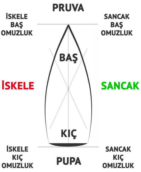

İskele(port) and sancak(starboard) baş-kıç(fore-aft) omuzluks (shoulders) must be clear on ships.
Unless your bridge is positioned high enough for a clear view.
Then there is no space at all.
