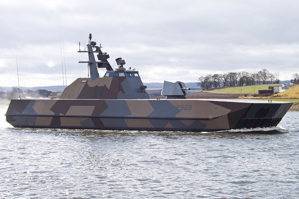

Or another unorthodox solution: " Visby class:The hull is constructed with a sandwich design consisting of a PVC core with a carbon fibre and vinyl laminate.There are multiple advantages to using composite materials in ship hulls"
650tones, stealth, 35knott speed. Range :2500miles!!!
