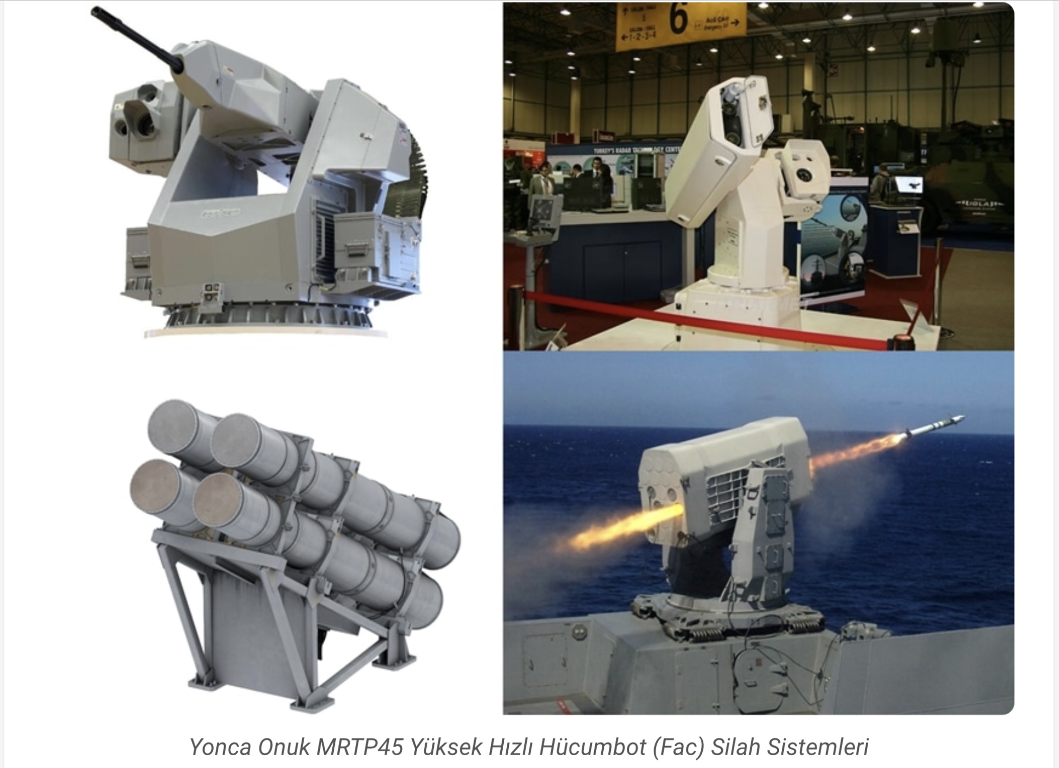

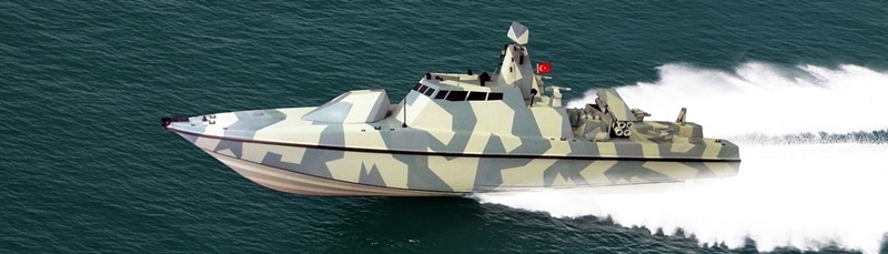

A good example with an ASuW configuration can be a 48m long MRTP45:
60 knots speed with weapons like these onboard plus ;
270 ton displacement, 2000Nm range, a 76mm gun and 2 x Aselsan Stops :
