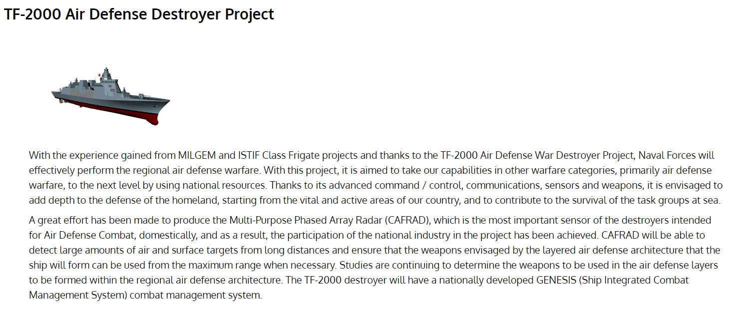

It is confirmed by Tayfun Özberk that TF-2000 "ADF" is just about the naming scheme of the programme. TF-2000 wont be a "frigate" so calm down.
also we will get to see the final design and news regarding the project soonTM
Man the project is 30 years old and older than most of the defence enthusiast or let alone, the defence media editors that spreads this sensation. If you carefully look, the older and wiser editors are silent on the matter, as since they know what it is actually about.
Frigate or Destroyer, even Navy could have been confused about these terms after all these years and moreover, the image given in the poster could be from an iteration between 2019 - 2022, of when the project was still referred as frigate. Also look at the model and notice 'conceptual' CIWS, missing Nazar and AYR radar and so on, it was not an actual depiction, or not a recent one of the project.
One last remark is that, i strongly believe DzKK considers variations (not batches) of TF-2000, thus the confusion of referring to it as frigate or destroyer emerges.
I can not confirm that the model is the old one but that sure looks like an old concept that is deriven in DPO and passed on to conceptualization-visualition process by another team. Use of black color scheme for radars show that it dates back several years, hence the 'frigate label'. You commented on the bow form on the twitter but man, how do you differ the nuance at the bows with one being low-res and at a different angle?
I don't think they would step down from the desired TF-2000 configuration, they have sacrificed a post, multi-functional frigate, and they will retain full configuration TF-2000 at 8500-9000 tonnes. And we seem to agree on a licensed multi-functional frigate if it becomes a necessity, or a dire need.
I don't like the +4 İstif class to be the same config. I think it is a wrong decision. UAVs and anti-ship missiles are proliferating fast. Even actors like Houthis can form strike packages of 15-20 effectors easily. I think we should rework the mast of İstif class. We should use the X-band AESA section of CAFRAD and put the Cenk-S on top of that. This will give uninterrupted lightning-fast 360-degree coverage in X-Band and long-range S-band rotating AESA will be a good way to complement it cost-effectively. We should also increase the amount of VLS as this setup will enable us to engage more targets at the same time. Even an additional 8x VLS will be meaningful if we take into account the quad-pack capability that will be available in the future. The displacement of İstif block 2 should be something like 3500 tonnes with these changes.
