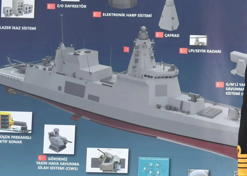

İn this picture, I see the answer to a technical question that I have been wondering about for a long time ."Two automatic cannons are at the front of the ship and at a lower level, so it means the turrets will have contact with strong waves and sea water." Then this is not a big problem. Conclusion : 2x 35mm CIWS can also be placed on both sides in front of the ship.

No more Nazar DIRCM on the rear?
Sünnetçi says there are still two, one in the back, but can't see it on this.
With Levent/Göksur and DIRCM, bow looks to be nicely protected to be honest. If the main gun can act as a semi CIWS as well, bow is the most protected side fo the ship. On the contrary, placing CIWS there, superstructure would block most of the aft looking angles.
The one on the back seems to be Ahtapot-EO to me, but still not sure.

I think the stabilized guns on the port and starboard side on the hangar aft deck are Aselsan STOP with 25mm cannons. It is a proven system that can operate in a wide variety of modes with high reliability and fully integrated into combat management systems. I don't know at what stage the production of ATOM air burst ammunition in 25mm caliber is at and whether it will be used in naval systems, but it is clear that these auxiliary weapon systems have gained serious importance, especially in the recent period, as surface asymmetric threats have evolved to another point with unmanned systems.
Surely very detailed calculations of all configurations are simulated. However, I can't help but wonder what a system with a much higher rate of fire per minute that can also engage surface kamikaze drones (like all of stabilized guns) would be like. Like MKE's Phalanx-like CIWS project. Probably the maximum firing range would be lower, also the total weight of the turret would be higher, and depending on the layout, can blind spots against guided munitions coming from the port and starboard sides of Gökdeniz which is main close-in defense system in the stern of the ship may create , but on the other hand, it can offer a better asymmetric surface defense and naturally a total close-air defense capability. I am of the opinion that everything that can be used in the self-defense of these ships against unmanned asymmetric threats, both electronically and hardkill, should be put in ship.

The drones seem to be Alpagu/Alpagut, the quadcopter was not shown in the render. I managed to count 40 pneumatic launcher for Alpagu/Alpagut, likely can be recharged.
The quadcopter count would have been higher.
