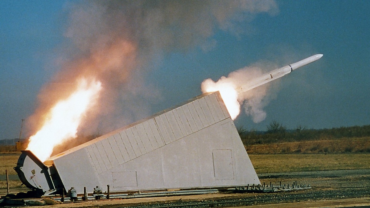

You don't need vls for everything. You can have bespoke launchers for smaller air defense missiles that you can fit more of. US uses angled ESSM launchers on their carriers as well for instance. VLS are, as I understand, more fore standardization to use a variety of missiles, which is more useful for a larger multi role ship. If it's gonna be the same missile for foreseeable life of platform, why bother?
It's just an updated Mk 29 that used to fire regular Sea Sparrows.
Yes but my point is its still a valid option over VLS, even brand new Ford class use it rather than some other solution. And to be fair, Göksur is like a hybrid between this and RAM, like a ram that launches sea sparrows, even has the same conversion from short range A2A missile lineage
BAE systems do work on an angled VLS launcher. Just saying.
That opens another can of worms though. Why showcase the twin launcher as standard? We'll probably see it on Istanbul soon and know for certain.
I remember seeing triple launchers and twin launchers on some ships of the same class at different times. Might as well be a peacetime/wartime configuration difference, just like using half the full AShM payload.
