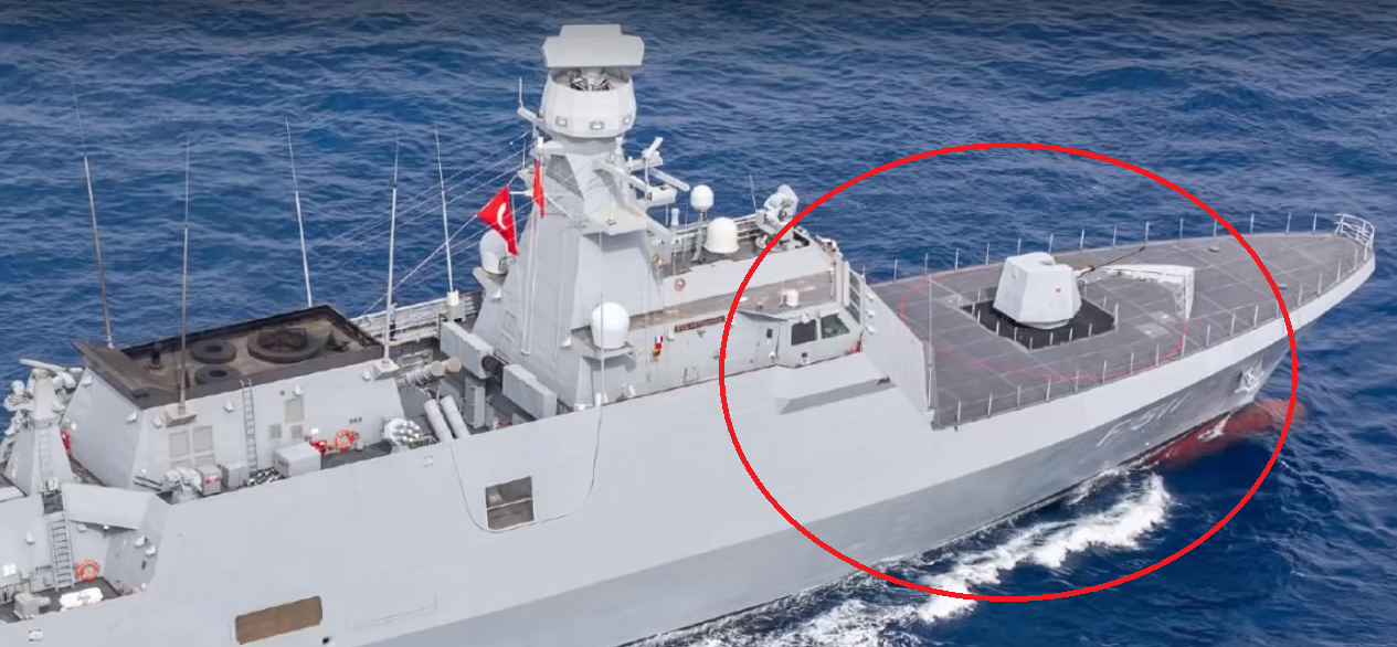

There is a very good space for 16x quadpack launcher in the front of the milgem. Yeah maybe mk-41 vls doesnt fit here, half of him must burry into hull but we dont know what they are. But for cold launch launcher we can set his tube sizes freely and we dont need burry him to hull we can setup his to front freeley. 16x cold launcher for g-40 or hisar-0 rf+ can fit to front easily. Just think only square on the floor of one missile. 16x can fit.
Like britishs did in type-23's ;
And 16x sam could be enough for ships self defence with ram.

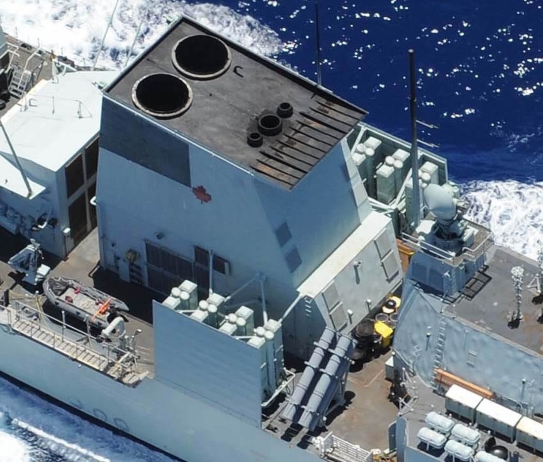

Nope, there are alternative locations, not behind of the cannon

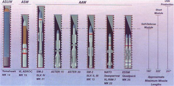

So we need 6.8 metered but max 260mm diametered long range air defence missile. And we have not much time for new missile. So for this reason missile could be 2 staged boostered missile just because our aa or sam missile ranges lower than 100-120 km. Using for first core missile section there are two options ; one of them Gökdoğan bvr and G-40 sam.
A quad-packed missile should be designed from scratch, if it has worked that way Aster class would have been already quad packed.
6.88 is not effective length, if it was, there wouldn't have been a strike length VLS. Canister clearance etc. ,the effective length is shorter.
Bro, I dont agree with you, but there are options, sides of helicopter hangars or behalf of ram etc. Cold launch launchers gives a this advantage.
That is not a rule. wings can be changed on the other hand we can use for first stage quadpacked g-40+.
Usable space of tactic modules are 5.6 meters. Possible lenght of gökdoğan max 3.5 meter, booster max 2 meter. total : 5.5 meter. İt still can fit.

Barbaros MLU is the priority among other modernization programs,it already has 16 VLS it just needs a modernization, and it is the urgency. If there is going to be a VLS on Ada class it possibly will be MIDAS in Self defense length. (4.8 meters) and in MLU.
I already told you there are "alternative" locations, not the behind of the gun. I once used to claim 8 cell VLS might be fitted on there, since i have seen some blueprints, it happened to an extended version of Ada-Class with 8 Cell Self-Defense (or tactical) length VLS. Later it has evolved to I-Class with further demands from Navy -possibly-. So in short, there are alternative locations for VLS on Ada-Class and it is not behind of the cannon, extension of the constructed hull is not possible.
One of these are the side of the hangars, it comes with additional issues. Cold-Hot launch does not matter.
You are right to not agree because you haven't seen structural plans of the Ada-Class around the fore cannon,at the foot of the bridge.
Usable space of tactic modules are 5.6 meters. Possible length of gökdoğan max 3.5 meter, booster max 2 meter. total : 5.5 meter. İt still can fit.
If i am not mistaken Gökdoğan with a booster is the G40, so yes it should fit.
G-40 is a version of gökdoğan diffrent wing typed and enlarged fuel sectioned version. G-40 will not use booster. İf you mix g-40 with booster you can be have siper kind of missile. But I prefer gökdoğan for first stage just because g-40 is not already finish.

Yes I didnt see the foot of the bridge, for this reason I offer not burried cold launch missiles. General lenght of missile 3.5 meter around and thats will not close the front of bridge vision. But on the other hands we can apply that kind of solutions with help of cold launch ;
Mk56 can be used on sides of the hangar nearby to the ladder- note the area around hangar is used for Replenishment at sea, not entire of it can be covered-, 12 cell version can be fit on each side /at maximum. Its height is about 4.65 meters with also deck penetration is required (3.6 * 2.7 surface). 5.35 meters occupied by Mk41 (2.2 * 4.3 surface) self defense module seems more reasonable at the same place.

Where do you plan to put gökdeniz on ada class ?

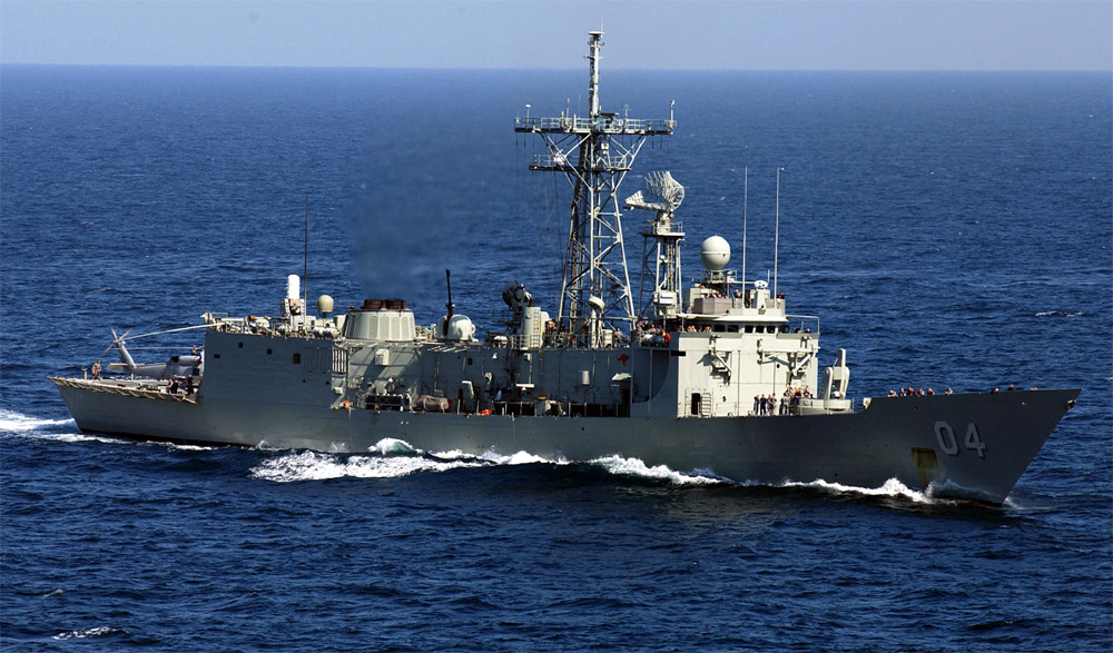

Why not just acquiring sm2 ER missiles for G class from USA until indigenous Turkish frigates have been revealed?
Australian navy sells its Gabya's Perry's with SM 2 modernization.
Then you could have some Arial defense capacity.
I am begging you please pay little attention on my avatar. At least 16 YTKB with Gökdeniz CIWS or 8 of YTKB with HİSAR O + would strength defense umbrella.
