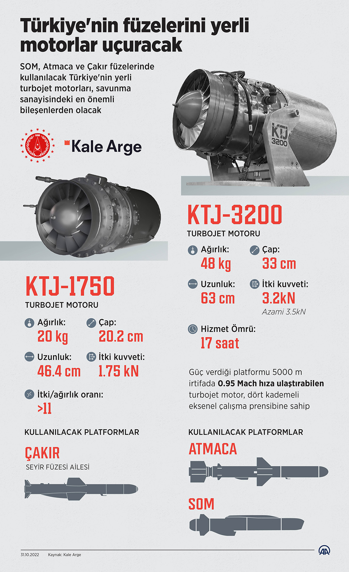

Nice infographic about KTJ-3200 & KTJ-1750.
15 8,744
Yes, KTJ-3200 can fly up to 17 hours.
No it can not. But it can operate for 17 hours without breaking. An air vehicle that is powered by one of these engines can not possibly carry enough fuel to fuel it for more than a couple hours let alone 17.
