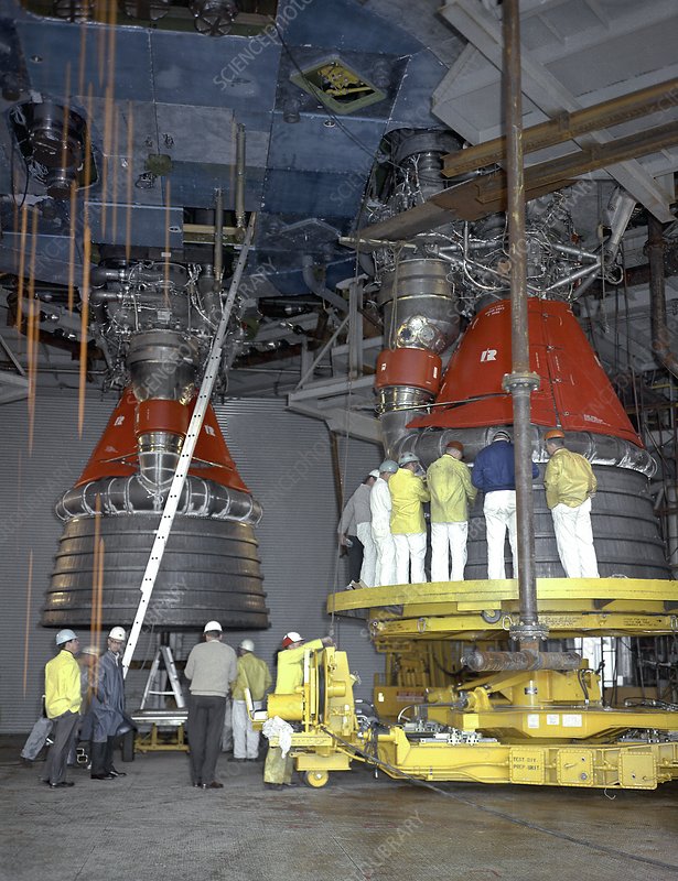

30 kn ? thats very small 30 cm diameter engine , better dont even post it .
While poor countries like india produces 800kn decades ago, we still produce 30kn ? look this what engine is
---> old 1960-70 F1 engine power Saturn 5 , Apollo mission.Even individual private Lost coutries at end of earth New zelands have produced better engine for electron rockets . 🤦‍♂️🤦‍♂️

Small engines are used for second and third stages or in space propulsion rather than first stage for launch from the ground.
Vacuum engines are bigger than the engines of the first stage due to the difference of ambient pressure.
A single Rutherford engine of Electron rocket produces 25kN force, which is lower than 30kN. But Rocket Lab uses 9 of them to lift Electron off the ground. The rocket is like a scaled down Falcon 9.
