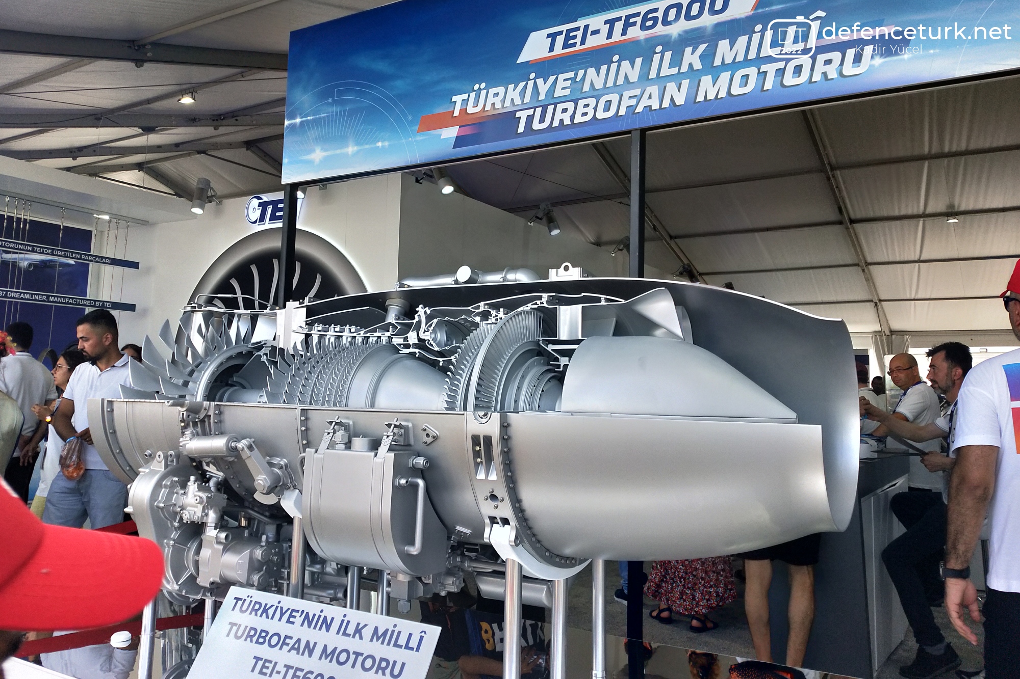

🔵🔵Explanations on the TF6000 engine from Mahmut Faruk Akşit
🔸TF10000AB afterburner turbofan engine will be developed
🔸For ATAK 2, the turboshaft engine will be developed over the TF6000 core.
There is a slight misunderstanding in the way it is translated I think. According to the article in Turkish, Dr Aksit is saying that the TF6000 can lend itself to various end uses; Such as if we made a turboshaft version, it could fly Atak-2 and if we turned it in to a marine turbine engine, it could power fast attack boats.
There are no concrete agreements about a turbo shaft engine as far as this article goes. But that is a possibility if needed.
Yes TF6000 as a turbofan is being developed. It is in final assembly stage. There should also be a TF10000 version with an after burner section. Due to excessive stresses applied to the engine by the AB section, this engine will be a different engine altogether. A bit like F124 and F125 engines of Honeywell.
