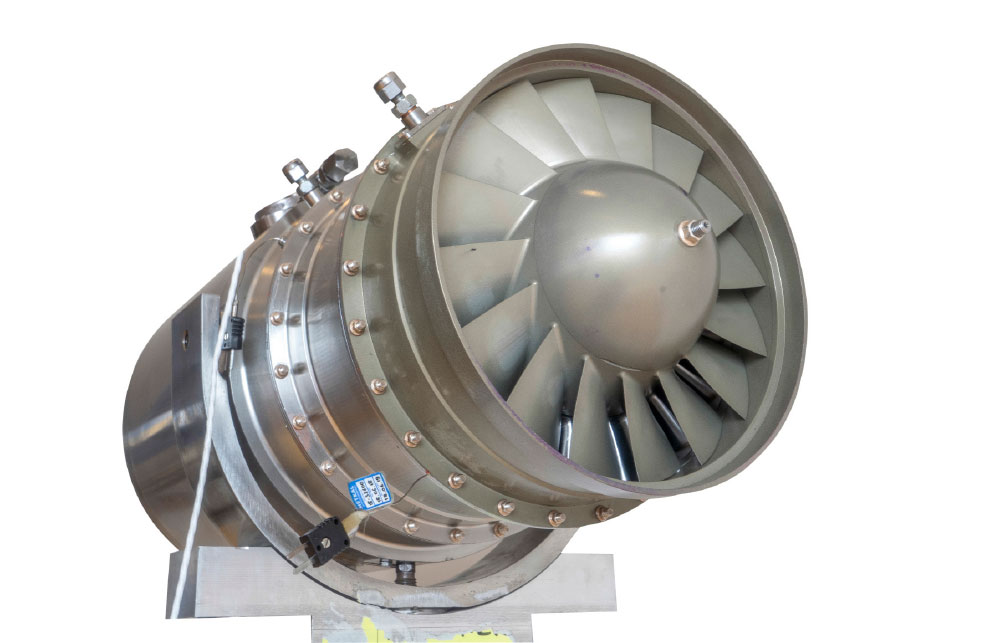

Dafuq are you on about? KTJ-3200 is done and ready
4,935
100 9,538
@-Sinan- iirc, in late 2022 ATMACA was tested with KTJ3200.
And SOM is supposed to be tested with KTJ3200 this year.
Heartbang
2,587
9 4,035
What about proving your words, instead of running your mouth ?
Afif is right, and so am I. It is ready.
