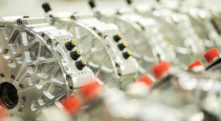

Yeah, axial electric motors have extreme power density and better torque graphs. Radial electric motors have higher total power output but have lower energy density and worse torque graphs compared to axial eclectic motors. Quark combines the best of both worlds (axial and radial electric motors)
