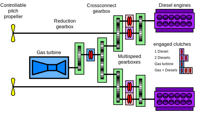

While it's awesome that Tülomsas has been on the market for so long and are building Marine Engines. I think a slight comparison is needed to understand how close we are to e.g. supplying Milgem ADA with a domestic Marine Engine.
Milgem ADA 31,640 kW (42,430 hp) RENK (MAN) CODAG
Two big Motherf**** engine supplying the ship with 42k HP.

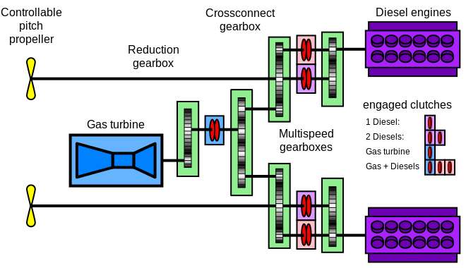

When we can build our own Marine engine for LDP and/or Corvettes, then we can be happy. Until then They'll be products that aren't utilized in any vessel and thus sad to say, but waste of effort because people want to see their effort be rewarded or motivation will be rock bottom, and we can go back to our assembly lines.
Just to clarify; The CODAG power of Ada Class is :
Total installed power is 42K HP. (That includes all 3 engines.)
The diesels are 2 x 5790 HP
The Gas turbine power is 31000 HP

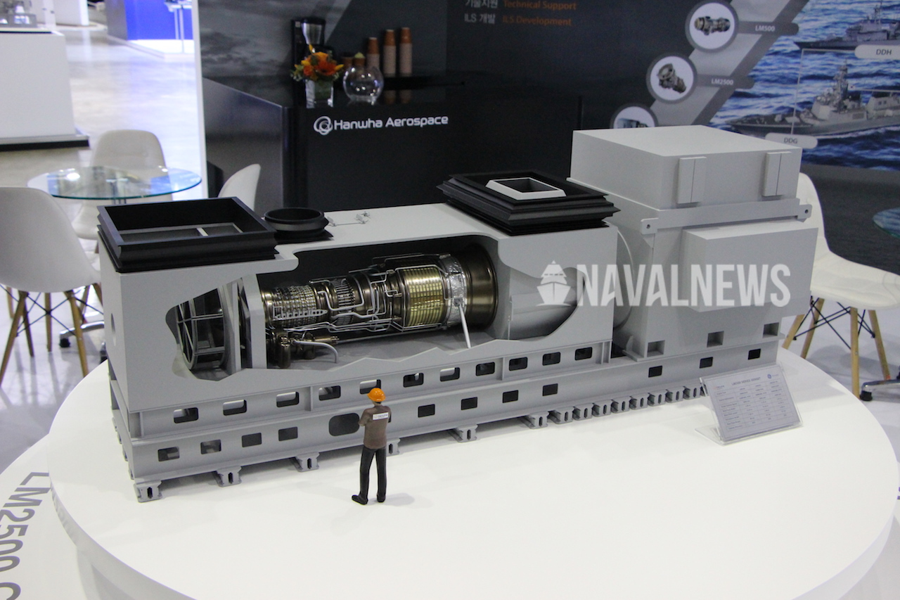

When it comes to gas turbines; Partnership of GE and TEI with the latest MOU signing where it clearly states possibility of manufacturing L2500 and L500 gas turbines in cooperation, is a godsend for us.
It is 31 MW, to be honest seeing HP did confuse me for a moment :).
When you work with folds of a thousand, HP doesn't really go well.

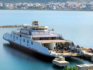

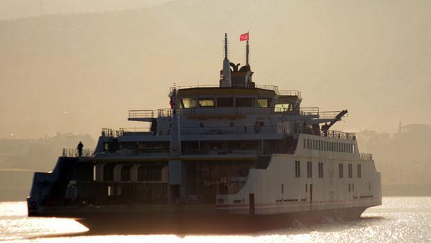

Tulomsas has produced 4 x 2200HP engines to power the largest ferry Turkey has. It is a 4000+ ton ferryboat carrying trains across Lake Van. Each engine uses about 400 litres of fuel per hour. There are 4 propellers and only a single engine can power all four propellers. As ferries go, this ferry’s engines claim to use less than all other current ones.
Feasibility of these engines in naval ships has to be looked into. But we have a factory that can build a domestic marine engine.

Tulomsas has produced 4 x 2400HP engines to power the largest ferry Turkey has. It is a 4000+ ton ferryboat carrying trains across Lake Van. Each engine uses about 400 litres of fuel per hour. There are 4 propellers and only a single engine can power all four propellers. As ferries go, this ferry’s engines claim to use less than all other current ones.
