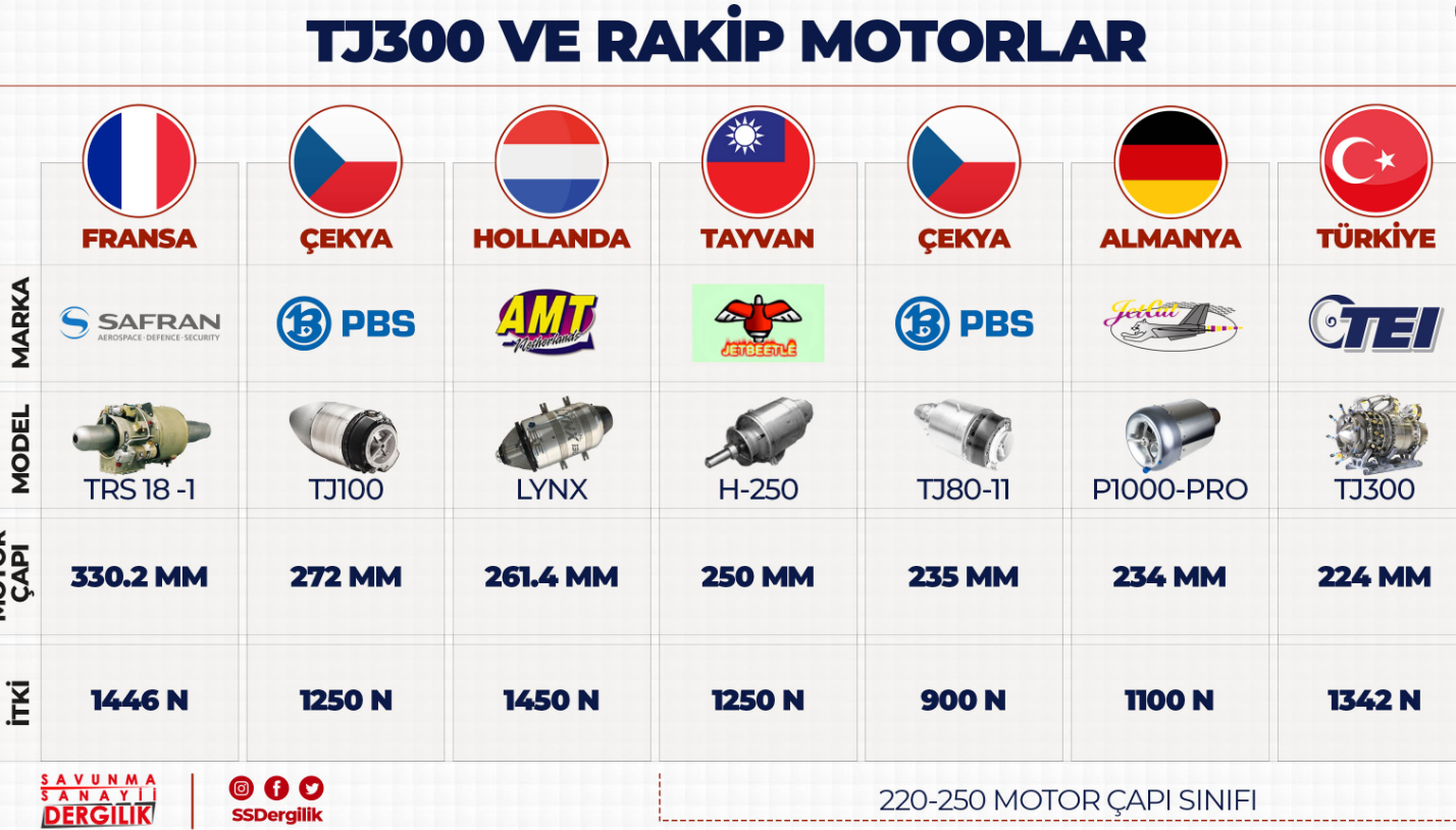

According to what available factual data that makes ktj1750 better than tj300.
I did not see any ktj1750 engine running but there are tests of tj300 reaching 1342N of thrust. Can someone enlighten me about it?
It depends. What kind of compressor is used axial or radial? How many stages the engine has in the compressor or turbine. We can't compare them without knowing more.
First of all please note that Kale names it’s engine according to the Newton thrust it can develop. TEI on the other hand names them according to the lbf thrust.
These engines are expendable engines. So they are not produced to very strict tolerances.
TJ-300, on paper develops 300lbf thrust; which is 1334Newton.
In practice it has reached about 5% higher than that.
But KTJ-1750 develops 1750Newton thrust. So it has more thrust.
This means that the CAKIR needed an engine with more thrust than TJ-300 could provide.
But the weird thing is that we know there is an engine TEI was working on called TJ-400. We all saw it‘s FADEC screen. That engine would have given 400lbf = 1779Newton thrust. Why it was not chosen is a mystery. (unless it was only available on computer and not physically) . However there is also the probability that the size of KTJ-1750 may be more suitable for the 275mm diameter CAKIR missile. (TJ-300 had a diameter of 240mm but not enough thrust. And TJ-400 may have had to have a larger diameter)
Also remember that due to CAKIR’s operational profile, it’s speed will vary from 0.4 Mach to 0.85 Mach. So the engine that is going to propel the missile has to have throttle up and down capability. We don’t know if this could be done with the TJ-300.
These are turbojet engines and will be producing jet thrust. So they have to have axial flow at compressor inlet and at turbine level. They usually have 4 compressor stages and 1 stage turbine. KTJ-3200 has a 4 stage axial flow compressor too like safran micro turbo engines.
TEI TJ-300 has a 4 stage axial compressor and single stage turbine like the safran tri-40 and 60.
The power output level is governed by the internal design and the rotational speed of these engines.
