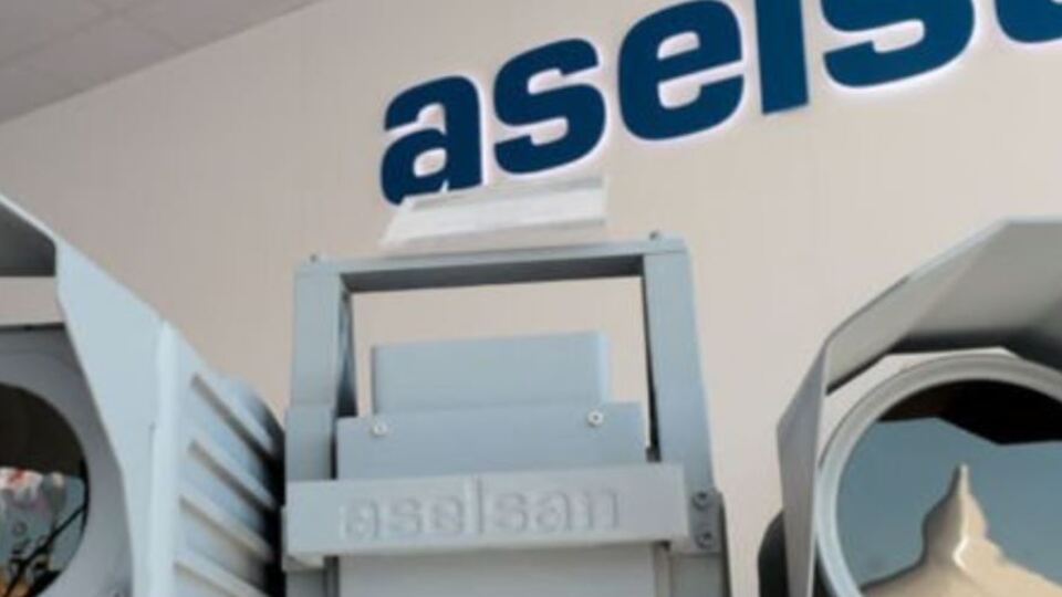

Wasn't EHPOD supposed to be this smaller one?

There are two different products; they both can't be EDPOD.
Edit:
EHPOD is on the left, and EDPOD is on the right.
Electronic Warfare Pod (EHPOD)
Electronic Support Pod (EDPOD)
4,299
274 22,477
EHPOD is the POD used to jam enemy radars and any missiles’ electronic systems.
EDPOD is the POD to let the plane know where enemy radars and electronic warfare systems are.
