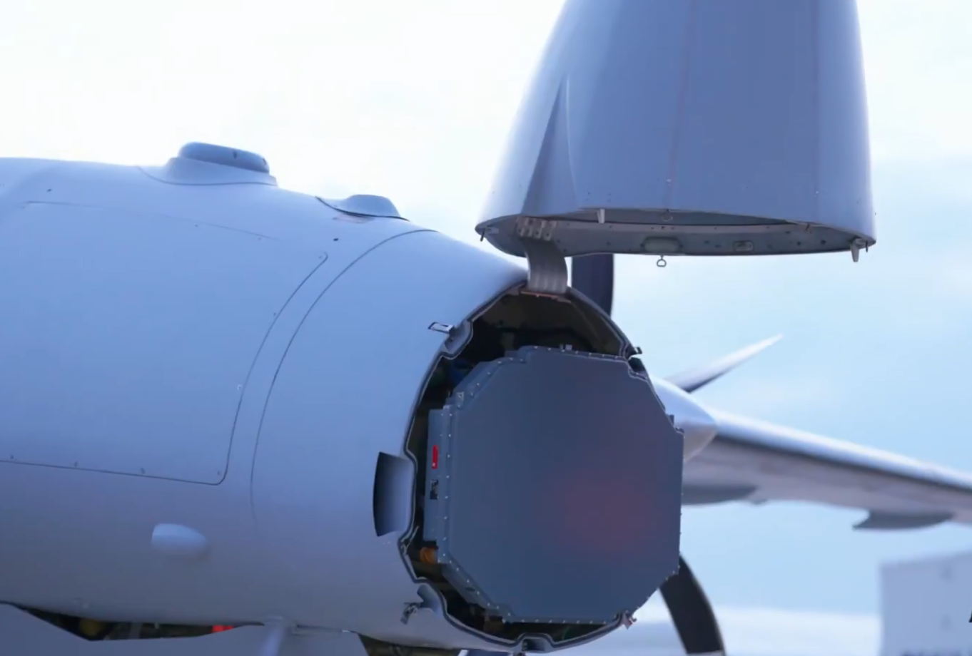

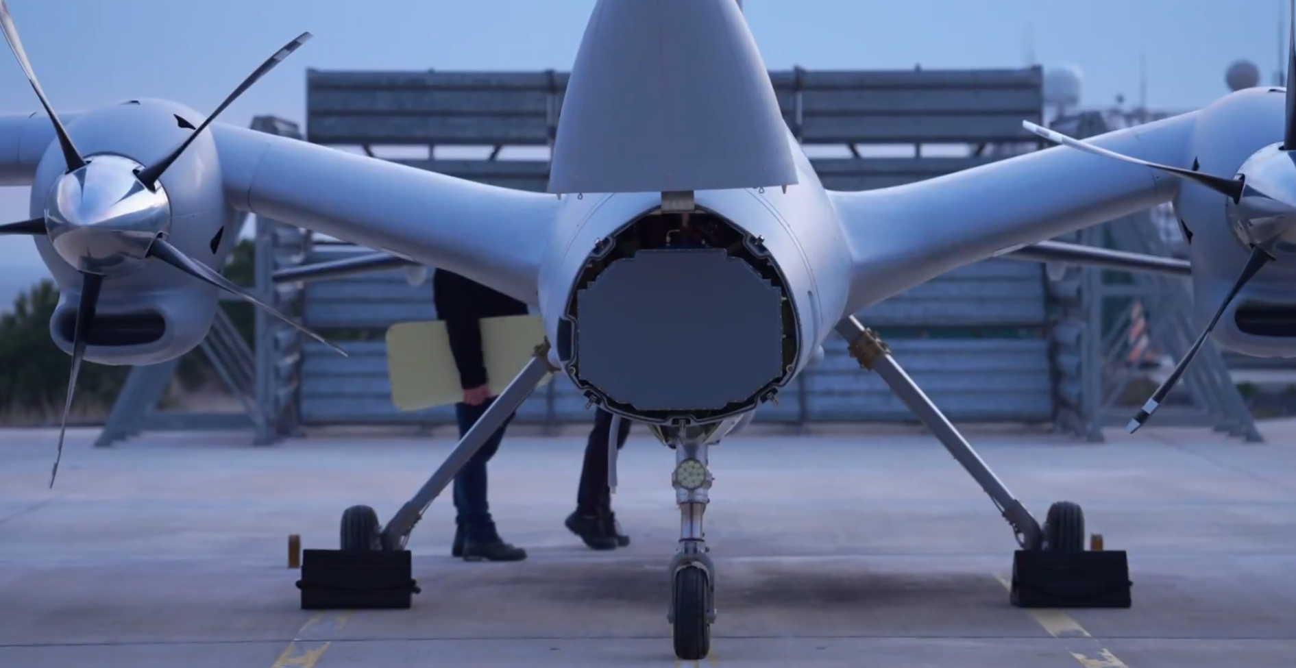

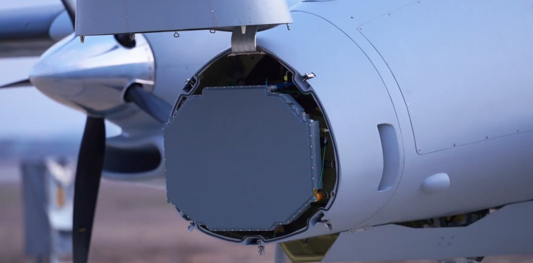

FULMAR 200-A Synthetic Aperture Radar (SAR) for UCAVs from ASELSAN!
— Aircraft integration of FULMAR 200-A continues, it will start flying with a Turkish UAV this year
— Turkey's lightest, least power-consuming SAR solution
— Factory tests have been completed, different configurations will come after integration
{#Radar}
The next-generation #FULMAR200A Radar System offers powerful reconnaissance and surveillance capabilities for aerial platforms with its lightweight, compact, and high-performance design. Utilizing AESA technology, it provides through cloud SAR imaging and multi-target tracking.
The Netherlands Correspondent
2,772
15 6,086
{#Radar}
For a drone like TB2 a range off 88NM is perfect, brochure says it is X-band possibility to guide a missile or asking to much :D ?
