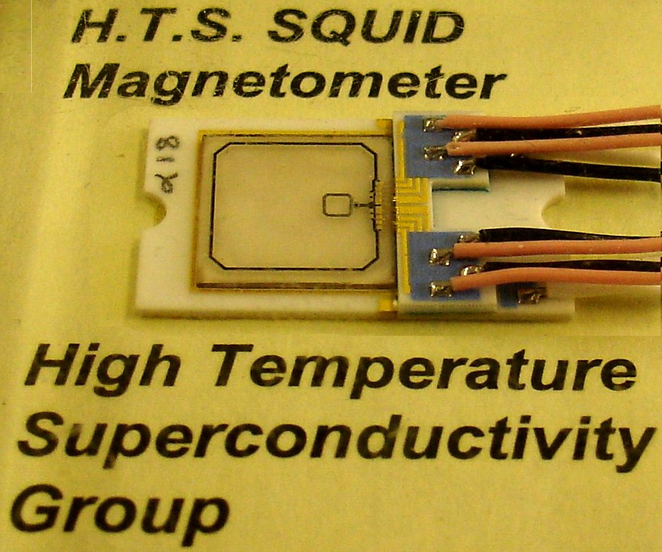

Quantum magnetic anomaly sensor will be based on a SQUID sensor and will aim to develop an advanced sensor for submarine detection.

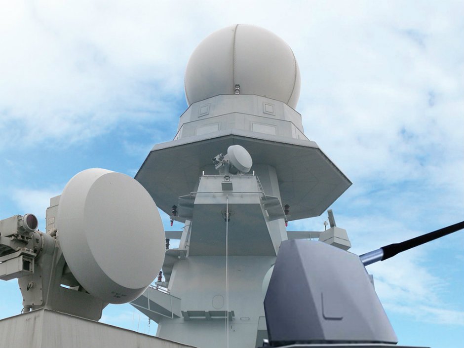

Siper Eirs + Çfr can be good sensor tandem for cheap air defence frigate for export.
Conic cover like fremms herakles can be good for sea condition protection

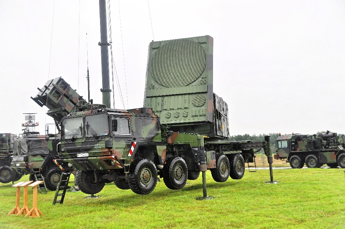

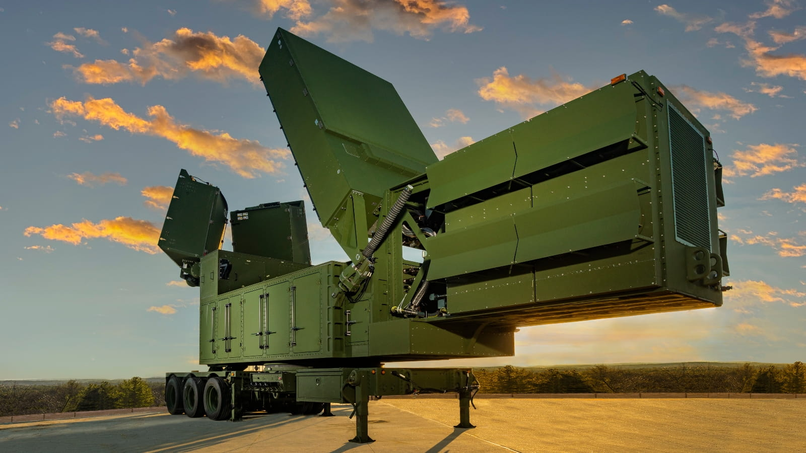

When it comes to Patriot PAC 3 i think we should now talk about the Raytheons new generation Ghost Eye radar which can track Hypersonics as well as LO targets.
According to the manufacturer.
The radar is designed for the U.S. Army's Integrated Air and Missile Defense system, but it will also preserve existing military customers' investment in the Patriot system.
And even with the Old radar PAC 3 is much better than S400 when it comes to in range interception.

When it comes to Patriot PAC 3 we should now talk about the Raytheons new generation Ghost Eye radar which can track Hypersonic as well as LO targets.
if you have a good enough radar, tracking hypersonic stuff shouldn't be hard

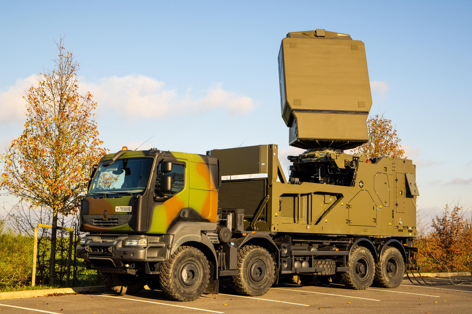

Well, we need to keep in mind that ARMs are not cruise missiles. they dont have the advantage of terrain masking. instead they rely on their low RCS and speed to narrow down the window of engagement.
And for that reason when it comes to Akbaba, it has critical speed advantage compared to HARM because of its unique Ramjet propulsion technology. As the terminal speed for HARM is considerably low as its motor burn out long before terminal phase and it basically glides its way toward target.
So, now lets say, even with an ARM with terminal speed of Mach 2.5/3 the window of engagement for a modern air defense system equipped with latest gen AESA sensor will be around 30/40 second.
WHY? because even with its very low RCS, against a big GaN based AESA like Ground Fire or Kronos Grand or EL/M 2084 it will be detected and tracked around 30/35 km.
Which is a pretty fat window of engagement for a system that can respond just in 5/6 second and simultaneously engage 16/24 targets.
