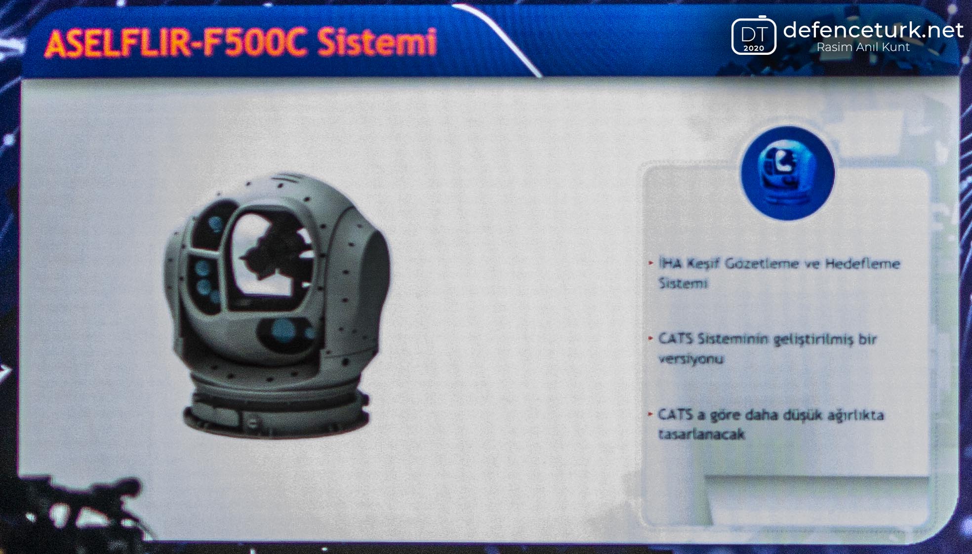

ASELFLIR-F500C
  • UAV Reconnaissance, Surveillance and Targeting System
  • Advanced version of the CATS system
  • Lower weight compared to CATS
Thanks to @DefenceTurk
On August 30, I found a master's thesis on Magnetocaloric Materials and Magnetic Cooling. I sent the thesis to an expert friend and asked his opinion. And when he returns to me, "it seems that it can open new horizons in infrared guidance systems and drone cameras with more precise, light, small, efficient, low cost and easy maintenance." said. That's why I think we are on the verge of breaking new grounds in guidance systems with ASELSAN FLIR technologies.
