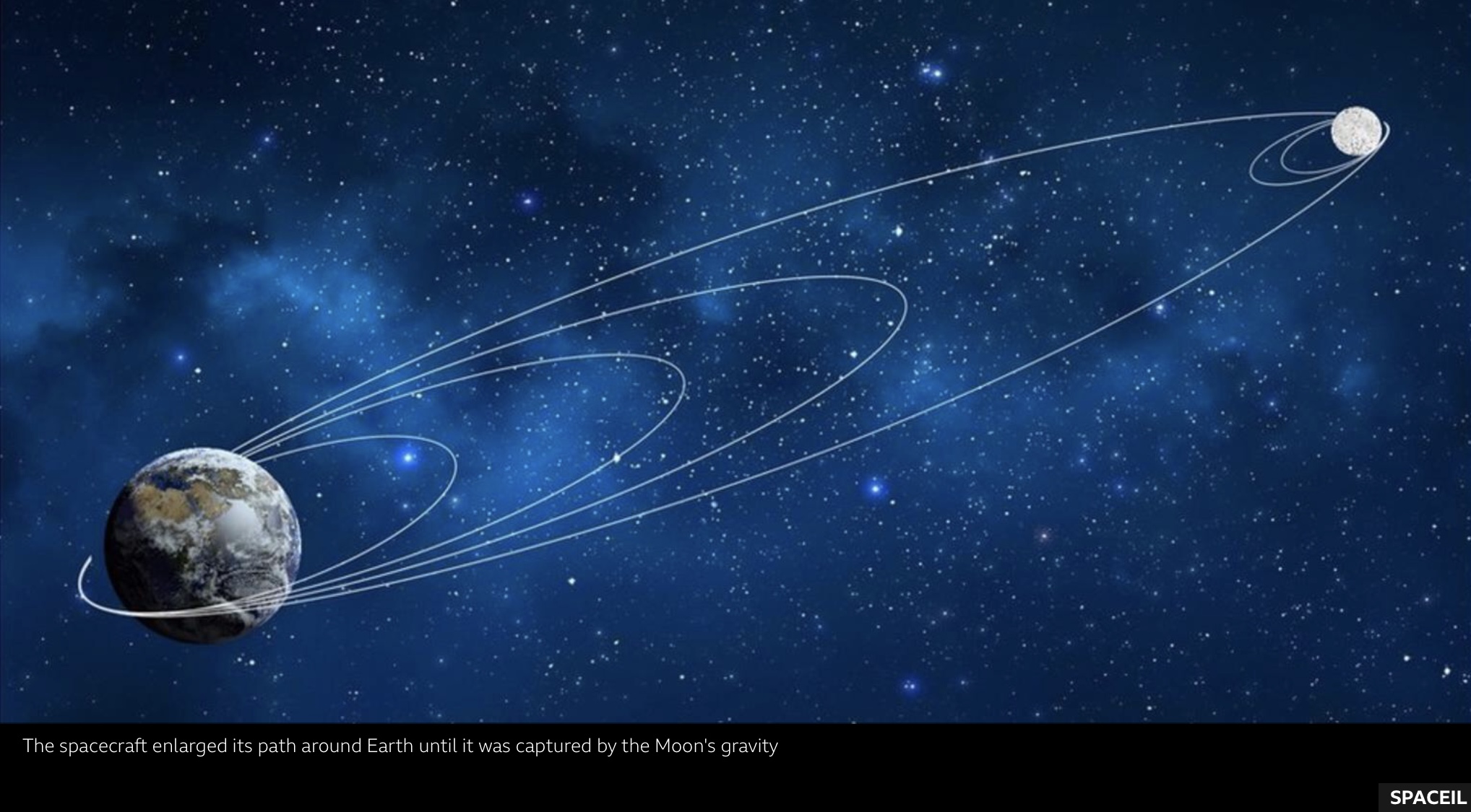

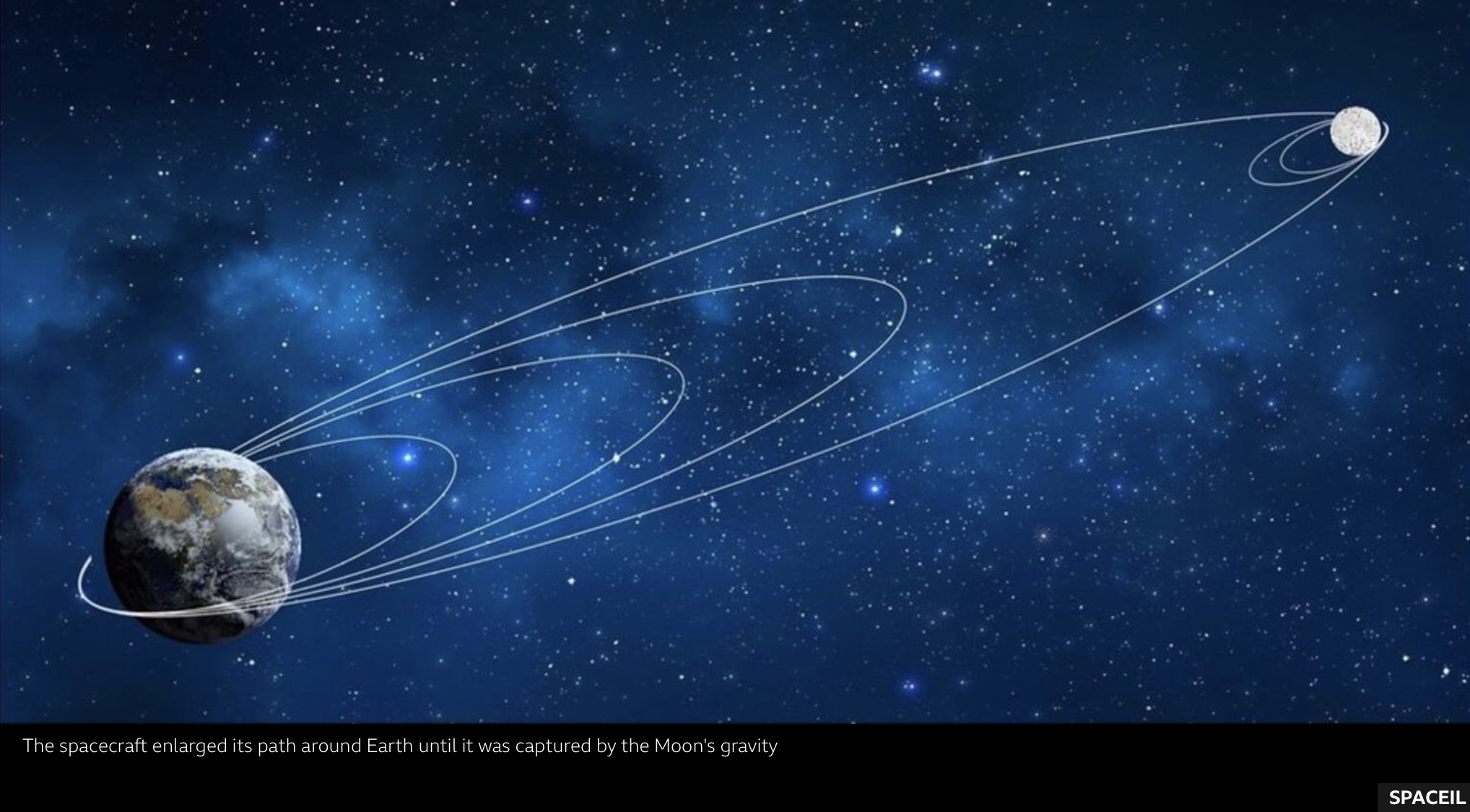

Beresheet moon rocket program cost them between 100-200 million dollars. Mission cost was 100 million. But it was a special system of reaching the moon that they used as it needed to be cheap. (Typical Jewish mentality. Get it cheap) and it took them weeks to reach the moon.
The average distance to the Moon is 380,000km (240,000 miles) - Beresheet travelled more than 15 times that distance. And the main thing driving this was cost.
Normally rockets reach the moon within a few days as they travel at high speed and a direct route. Beresheet was a normal satellite rocket that swung shot around the world 15 times ; each time increasing its orbit and speed finally it was far away from the earth to be able to reach the moon. I don’t think spacex will use this method.
Nevertheless the Israeli effort was ingenious and well worth what it has achieved.
Yes India did same thing as Israel. Both were constrained by the payload available (Israel's was a secondary payload on falcon 9 to cut cost, whereas india used PSLV and GSLV which do not have requisite heavy payload capability for large orbit thruster that can do one direct burn).
This means their orbit thruster is only so big given smaller mass budget available....so to get the delta v needed for TLI (insertion into lunar trajectory)....it needs to be staged over more burns.
Say a big thruster can impart 1000 units of impulse all in "one go" (in one minute say)...and 1000 units is what is needed to get TLI condition.
But in same minute of time, say a smaller thruster can do 200 units of impulse.
It basically would then need 5 burns (5*200) to gain the total 1000 units needed for TLI (trans lunar injection).
The smaller the thruster, the more burns (and orbit raises) you need till the final one does the TLI...or TPI (trans planet injection) if its a planet or sun etc.
Why not just run the motor longer you ask compared to doing separate burns discreetly?
Well it needs to do these 5 burns discretely as the appropriate window to do a burn is short (that 1 minute around perigee/apogee when energy transfer is most efficient to increase or decrease delta V).
I explain bit more here:
SpaceX has full heavy launch capability like NASA, so they can do it in just one burn for TLI...given they can put a huge thruster on the final stage...given the starting launcher size is capable to launch this sized payload to LEO.
