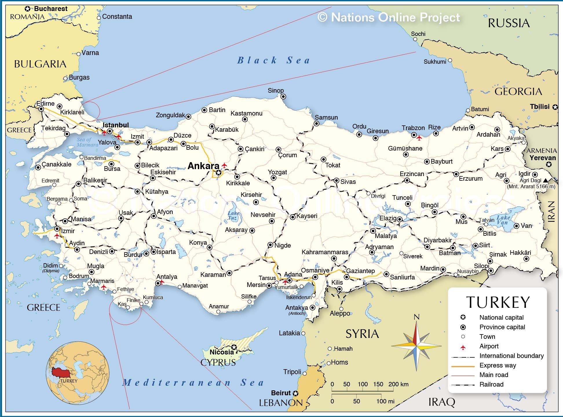

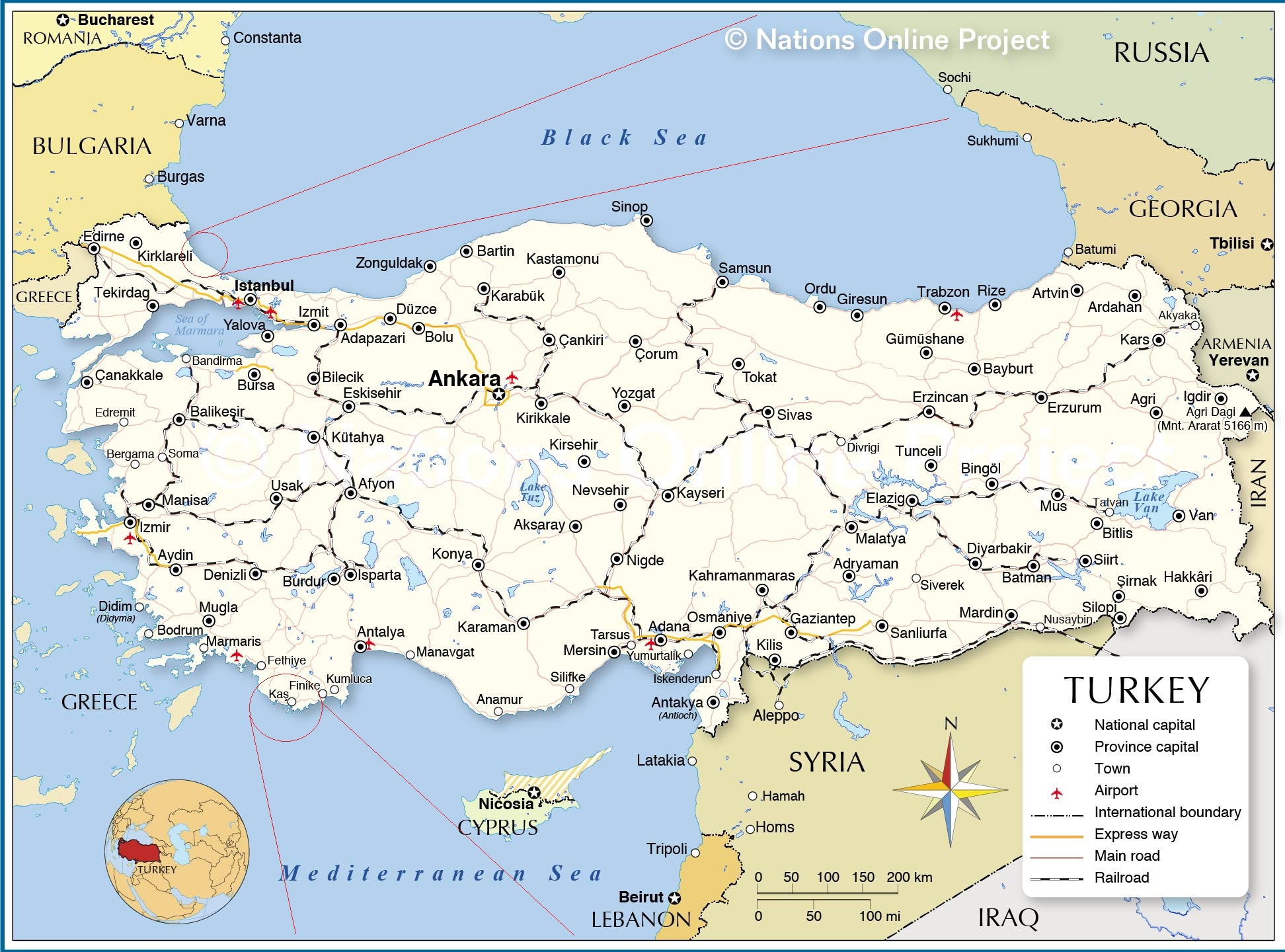

If its Sinop that will be it..... it (max size) can be calculated fairly easy when I get some time later....as you simply look at the range available for 1st stage debris and backwork to get its rough largest size.
i.e sinop to georgian coast roughly would be the distance to calculate from that sets bound for 1st stage.
Thats why earlier I proposed thrace, it will give a larger size/scope for largest rocket turkey can launch (at least due east wise)
Darca (close to area I proposed too) can be developed for 2nd site, especially for polar orbit, since those benefit from due south launch.
Here is my earlier post for readers:
Map ref:

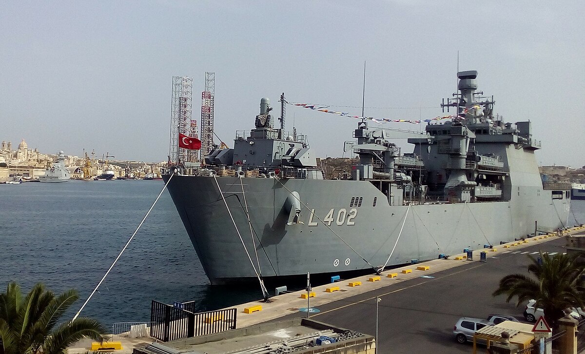

It would be best to develop any logistics like what EU/France done with French Guiana. Roll-on roll -off ships:
Then you got to do assembly in situ in vertical-assembly area, then move final-vehicle to launch-pad and you launch there.

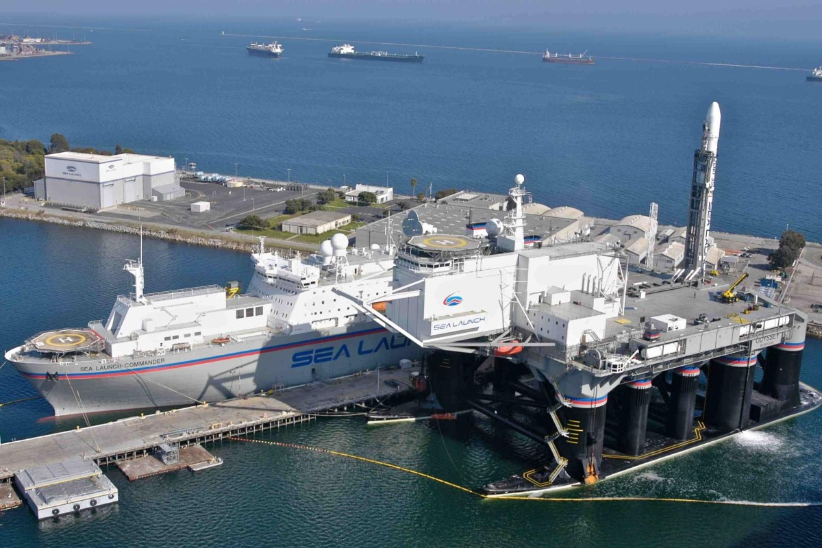

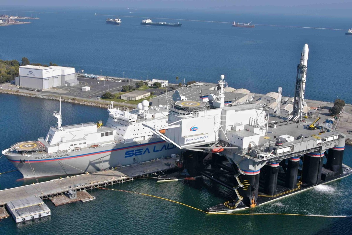

Launching from a ship presents major difficulties w.r.t stabilisation + strength of launchpad needed. Indian Navy for example for open-deck-based prithvi BM (since canisterisation/VLS was not found economical for the ships in question for BM this size) launch had to develop a pretty intricate stabilised platform just for that size...it was far from ideal too.
That's why sea launch had a very large ocean rig platform for the launch itself (next to a CnC ship etc)....for a lot bigger rocket:

You need to mind the second stage too, these two locations were chosen with that in mind.

2nd stage wont be so much issue with this sized launcher....it can be designed to do re-entry with burn up in atmosphere. A retro burner can change the re-entry angle if needed.
Turkey can model and do that, likely already has....its no problem. 1st stage is really the survivable thing of largest risk in general.

A roll on roll off system is probably the most cost effective option which can minimize the security risk too. Depending on the busyness of activity and other factors a floating option or a full blown land base can be viable. But the stated $350mn cost estimate for the spaceport probably probably says something for what is in the minds of the officials.

Turkey is constrained in such endeavour by geography somewhat, but here are two sites I think will be good for mid-sized future launch as the launch bearing window is goverened by:
- As close to east as possible (for maximum velocity imparted by earth rotation)
Equatorial rocket launch is not affected much by the longitude of the launch site, rather by the latitude of the launch site and the direction in which the rocket is launched.
Launching a rocket eastwards will help impart greater velocity to the rocket, I believe.
Purely due south launch can be looked at for 2nd site too, if Turkey wants to do polar inclination only.
I am not aware of any benefits or penalties from a strictly southwards launch of a rocket on a polar orbit.
Could you explain what are the nonpolitical benefits, or penalties, for a rocket launched southwards on a polar orbit?

Our LST ships TCG Bayraktar and TCG Sancaktar seem to be very suitable to carry out operations regarding the delivery of parts and personnel and possibly fuel to the spaceport.
Also a second hand ship can be bought and re-purposed as a launchpad if it is deemed suitable.
