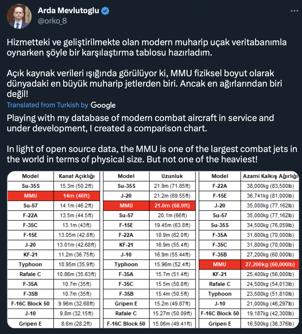

MMU will have crazy thrust/weight ratio even with the GE-F110 engine, with those planned 2x35.000lbf engines it will become a real monster.

I had noticed the weight being off earlier and this may be related to the fact that the TFX need to be powered with a lesser engine in its initial iteration and will be upgraded to its full potential later on with following iterations powered by a domestic engine. When powered by a domestic engine its MTOW will probably increase allowing for an increased payload capacity as well. And remember that the TFX is expected to have better agility than other fighters calculated based on its geometry. See the sketch in my signature.

TFX uses some large 3D printed metal parts including the main bulkhead which can supposedly be much lighter than a routed out part. This along with extensive use of composites allow for a light dry weight of the plane. However the MTOW is related to engine power as a variable which is in turn related to the speed of the plane. With a more powerful engine comes a bigger MTOW and the smaller dry weight of the plane allows for a bigger payload fraction. Obviously parameters will change with the engine power installed.
