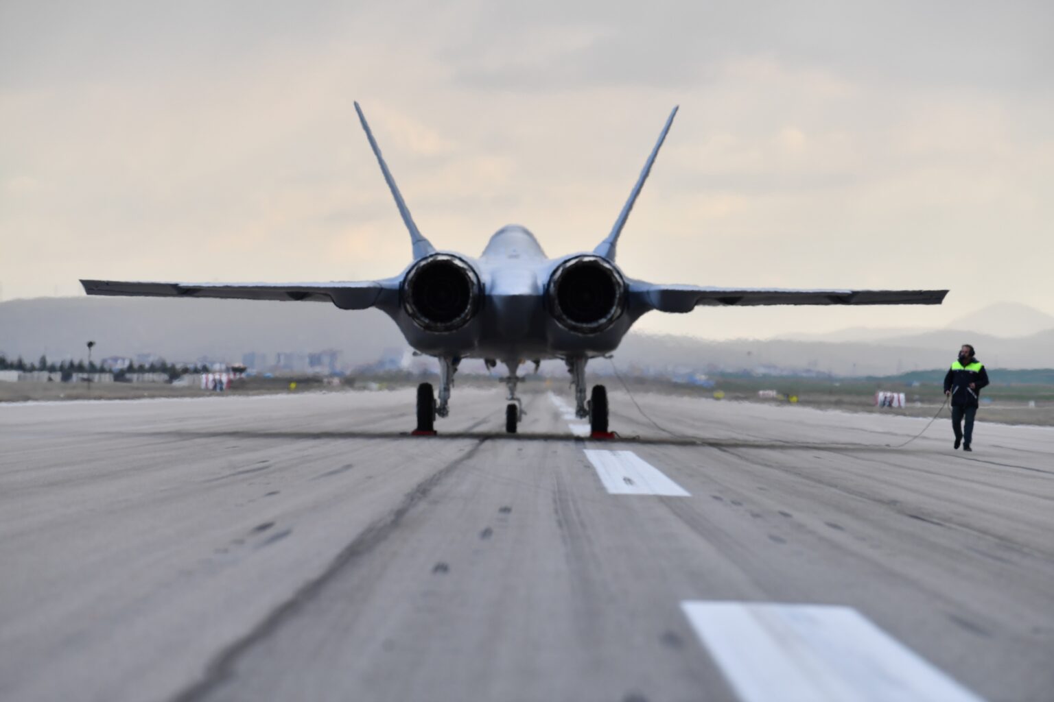

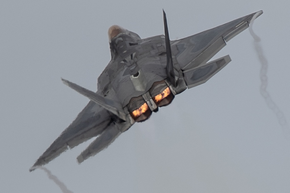

I was refering to the fact of vertical stabilizers being directly on the engine humps.
Notice the F-22's vertical stabilizers' position. They are not mounted on the engine humps, just right next to it.
And this is KAAN for comparison:
I know what you are referring to. But like I said... There currently are, in the short term at least, no plans to move the vertical stabilizers to the side booms.

AFAIK When designing stealth platforms one must avoid 90 degree angles in the geometry whenever possible, wherever it can. And those stabilizers do look like they mounted with an angle of 90 degrees on top of those engine humps.
Ill wait for the 2nd prototype to appear, and comment accordingly
