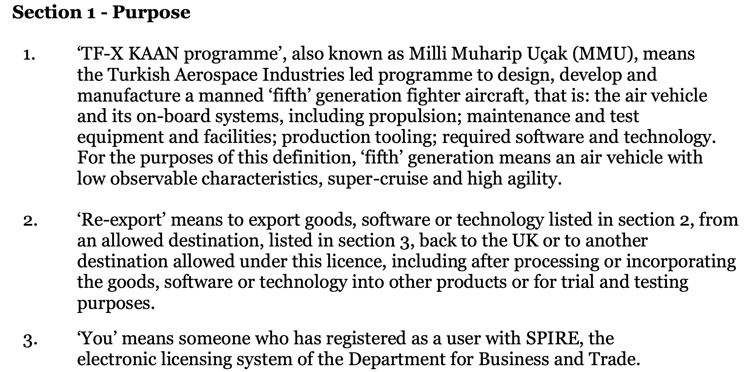

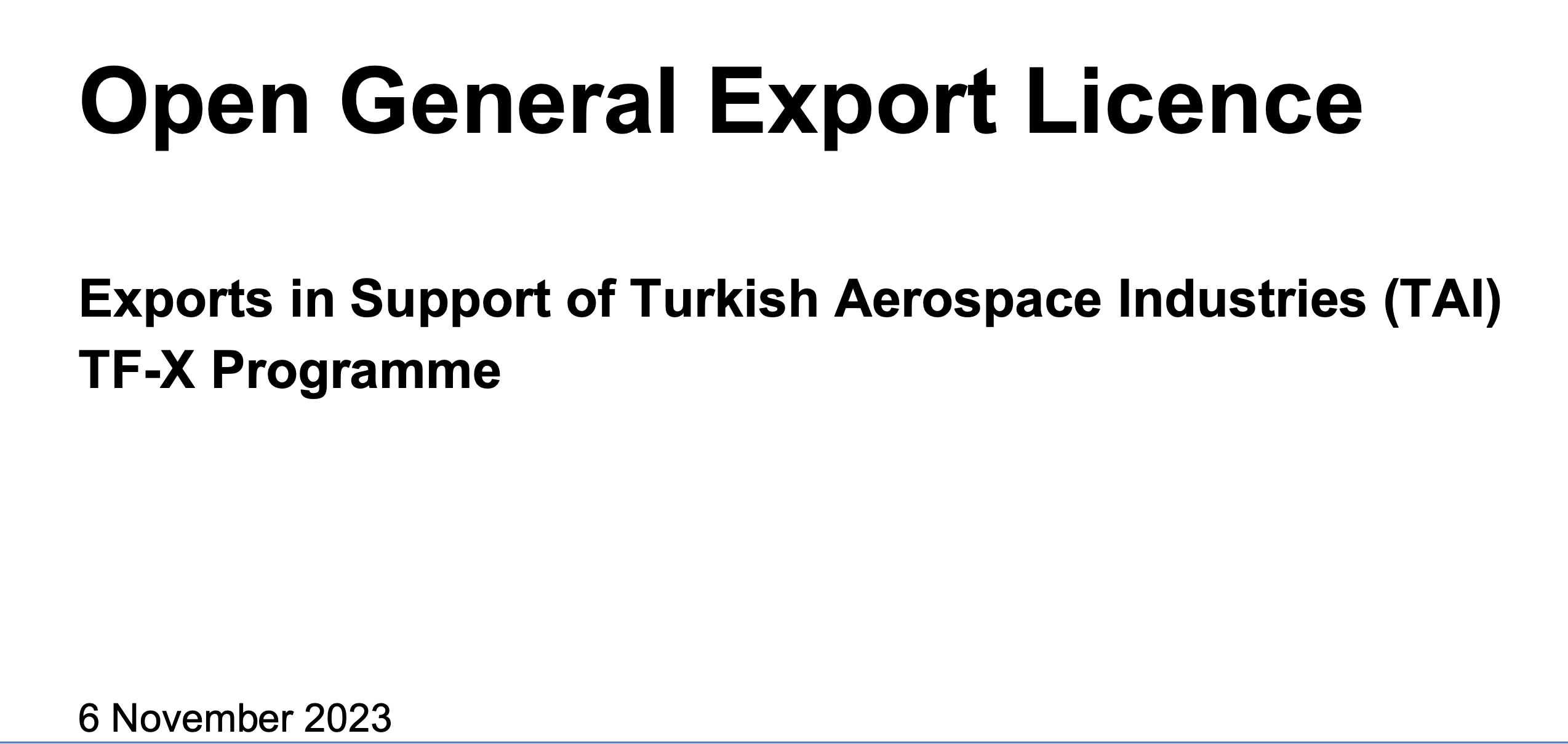

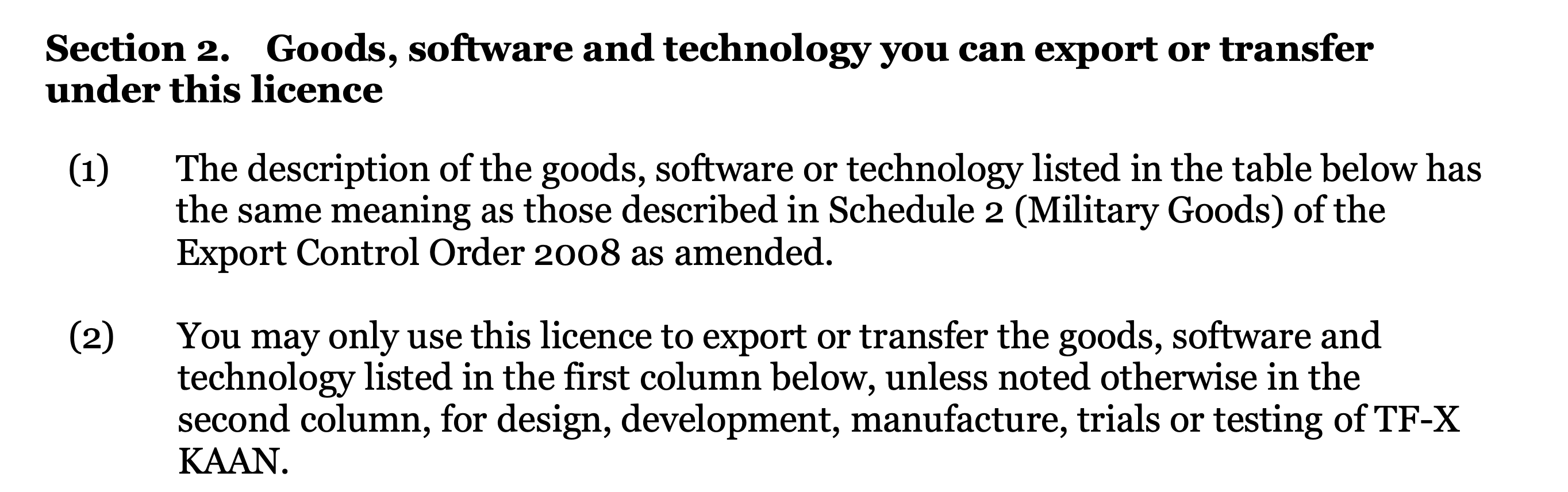

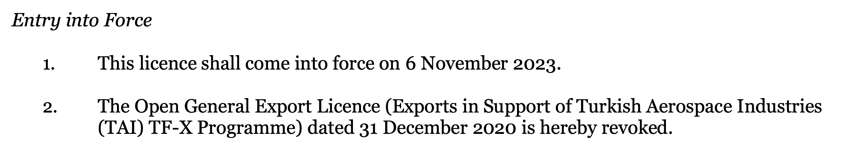

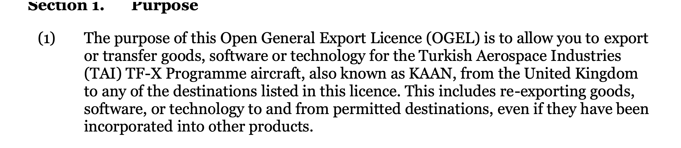

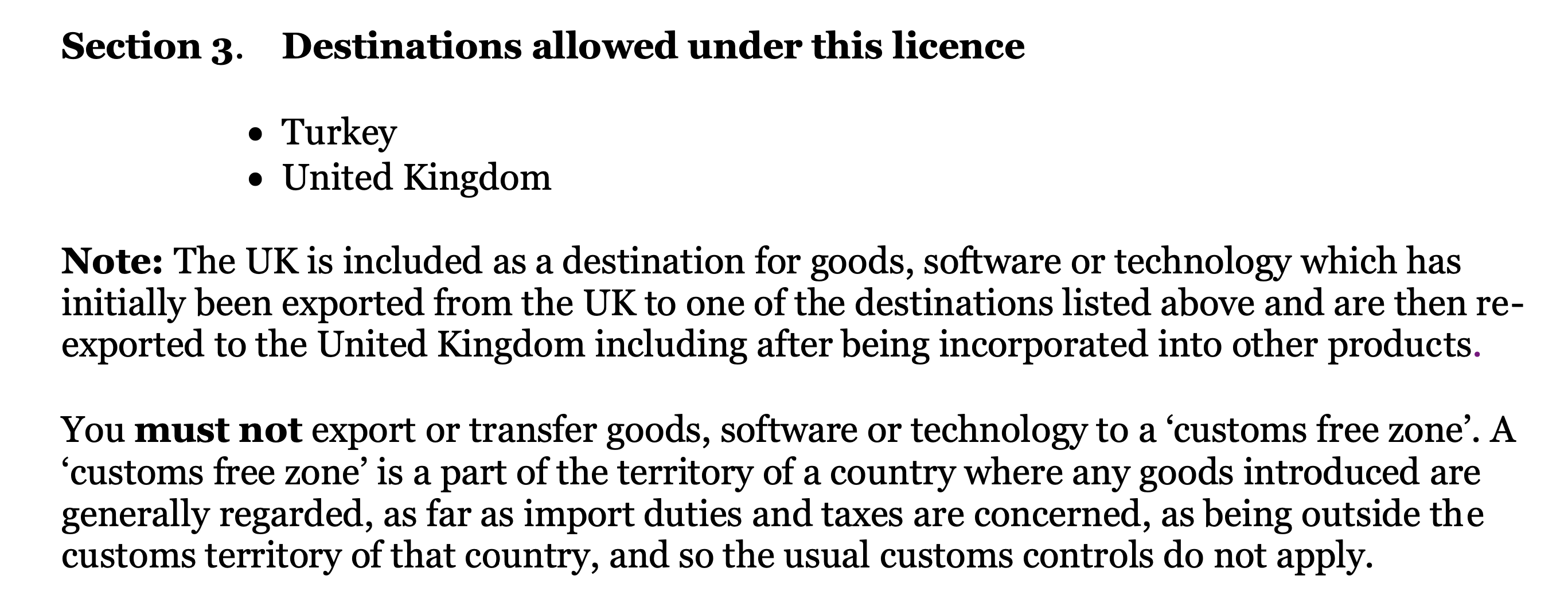

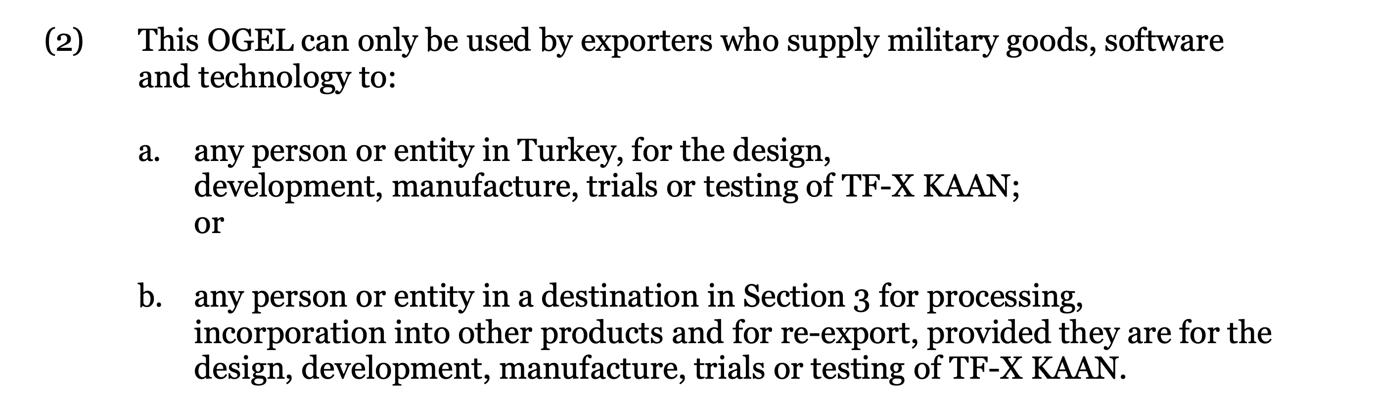

Something I found...
The U.K.'s Export Control Joint Unit on Nov. 6 replaced and updated its open general export license for goods in support of the Turkish Aerospace Industries TF-X program. The new license replaces the revoked license and allows for the export of "software or technology for the Turkish Aerospace Industries (TAI) TF-X Programme aircraft, also known as KAAN, from the U.K. to" Turkey and, in the case of reexports, the U.K.

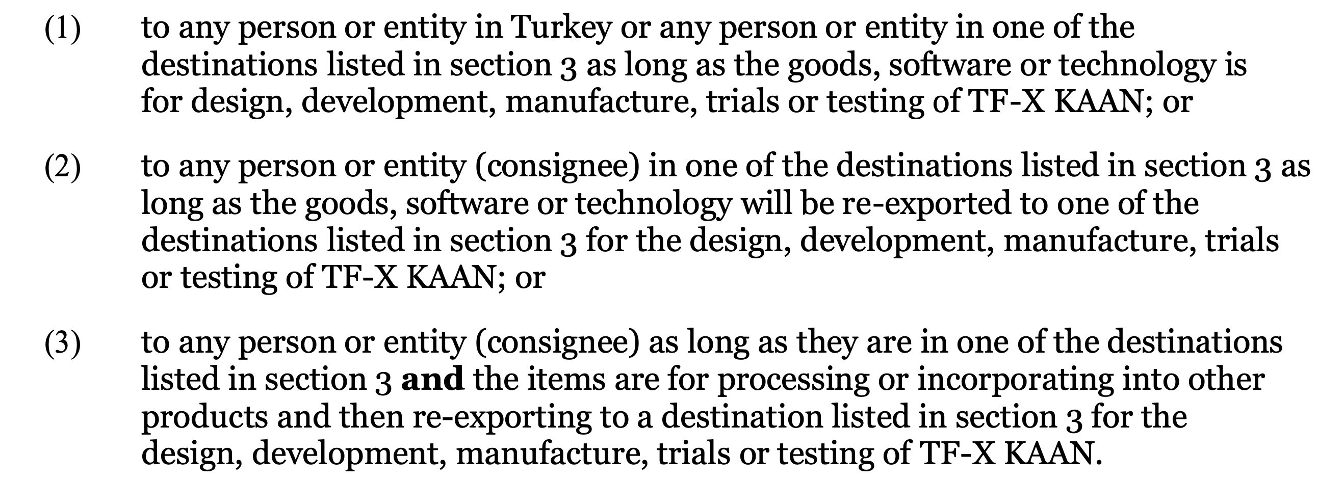

Having read the whole document, my understanding is such that, it includes every technology related to KAAN, including propulsion systems.
But the document actually is related to UK companies. It tells UK companies they are free to transfer and release all related technology with respect to KAAN freely to Turkish companies.
They can not, however transfer technology to third party countries using the Turkish companies. So it is restricting UK companies.
So if we were to give an example; RR could transfer all necessary tech to Kale to produce an engine together. Also if RR seemed it relevant, could re-export this technology only back to UK. Not to another country, say to Qatar !
The restrictions are for UK companies’ benefit. It does not encompass Turkish companies directly.
Edit: There is however one interesting point; UK companies can not utilise technologies gained in the process of developing KAAN, to be used elsewhere apart from U.K. In other words say, RR stumbled up on a new tech whilst developing an engine with KALE; it can only transfer that technology back to UK. It can’t transfer it to US or Japan or Germany.

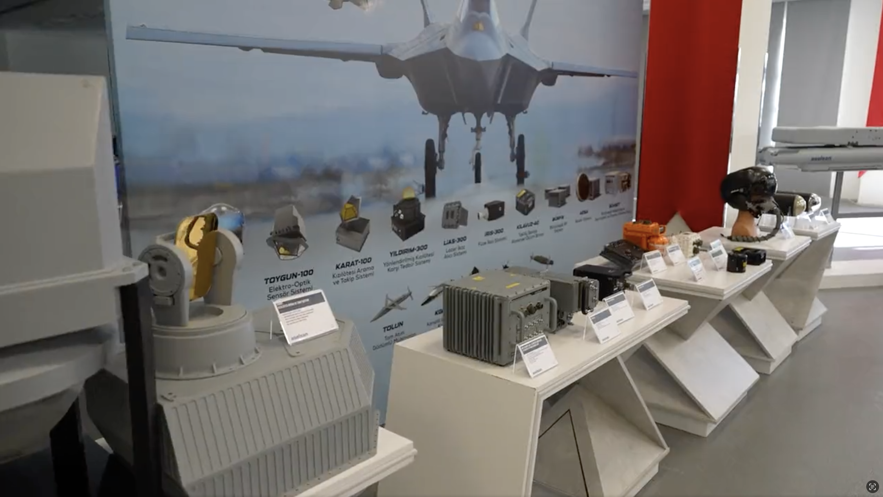

It would be helpful if you added meaning to the letters so that people like myself(amateurs) know what it means.
DAS(.........)
MWS(........)

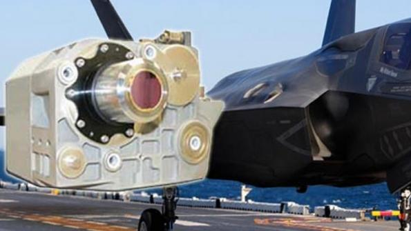

DAS- Distributed Aperture System. (on F-35)
MWS- Missile Warning System.
Siper>MMU
542
2 1,191
It is IR based, having no scale doesn't help with the image
I also remember it being IR based but the image is confusing. DAS(Distributed Aperture System) has 640x480p cooled MWIR/LWIR (Mid/Long wave infrared) dual mode detectors for now(they will be upgraded to 1024p ones in Block 4). Cooler assembly takes so much space alone, with the electronics taken into account whole system becomes quite big like DAS. There are a couple possibilities.
1) The illustration may be misleading,
2) We may not get a sensor as capable as current DAS. Maybe with an uncooled sensor or a lower resolution MWIR/LWIR single mod sensor. But I doubt it since ASELSAN is already developing a dual mode MWIR/LWIR detector kit for KAAN.
3)I think this is the most possible one. We will see a IR based only MWS(Missile warning system) capable sensor for Block 0/1 and get a upgraded true DAS system with further blocks.

I also remember it being IR based but the image is confusing. DAS has 640x480p cooled MWIR/LWIR dual mode detectors for now(they will be upgraded to 1024p ones in Block 4). Cooler assembly takes so much space alone, with the electronics taken into account whole system becomes quite big like DAS. There are a couple possibilities.
3)I think this is the most possible one. We will see a IR based only MWS capable sensor for Block 0/1 and get a upgraded true DAS system with further blocks.
It is specified as an IR MWS and imaging system, unlike İris-100 which is just "MWS"

From the F-16 Forum:
"[...] Key attributes are dual-band MWIR (3–5 mm) and LWIR (8–10 mm) using a 640x512 FPA. Each sensor measures ~7x5x4in (18x13x10cm = 2400cm³), weighs ~9lb (4kg) and consumes less than 20W [...]"
So the DAS sensors units aren't that large, and this source is quite old. It might be that IRIS-300 is deeper than it is wider.
Optical assembly:
DAS unit:
Front-facing DAS (right, next to MADL) integrated below canopy, notice the added hump:

A good presentation of what DAS is and what it can do. (Here it says DAS is HD)
moz68k
127
19 627
Switzerland
Yeah HD is marketing speak in that context, current DAS is less than 1MP (he might mean that the stitched image is HD, which is true). At 41 seconds, you can see the Northrop rep holding a mockup unit. Wide and tall but not that deep. Plus, we really don't know the scale of IRIS-300.
5,135
104 10,039
Well, this is actually old DAS from NG.
Afaik, not in the production anymore.
New EODAS from RTX has been delivered to Lockheed Martin to be integrated with Lot 15-17.
"The sensors use two key components from across RTX: the strained layer super lattice (SLS) detector material (from commercial foundries) is processed using the same revolutionary manufacturing techniques to develop the GaN semiconductors in Andover, Massachusetts, which power Raytheon radars such as Patriot, SPY-6, and LTAMDS. The EODAS SLS detector material is then integrated into focal plane arrays by engineers at Raytheon Vision Systems in Goleta, California. These advancements, coupled with digital pixel technology and a digital read-out integrated circuit, give pilots a quick, high-definition picture of everything around them, culminating in a more capable missile detection system."
Electro-Optical Distributed Aperture System | Raytheon - RTX https://www.rtx.com/raytheon/what-we-do/air/eodas
No definite specs yet. (That I know of)
But seems new EODAS from RTX is significantly improved.
F-35 DAS stitches IR video feeds and puts a box around aircraft without even giving numbers to it. Turn the plane a bit and you lost the track of who is who. DAS alone is not enough SAR has a higher resolution which allows it to actually IDENTIFY the object. Is it a SAM or is it just civilian truck. What model is that SAM. Draw a circle around its detection range and engagement ranges. Now THAT is useful info. Screw the whale.
5,135
104 10,039
That is not how DAS works. It's 360 sensor connected with HMDS. (Helmet mounted display system)
Its primary role to function as MWS. (missile warning system)
