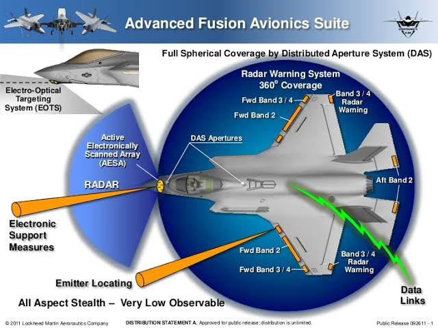

As per my info .
Aesa can listen some designated frequency , and receive such .
It's pre decided what it's going to listen to , any random frequency is considered noise and thus removed , that's why radar are optimised for high gains so that the required frequency don't get removed in noise .
When received it goes through converter and further interpretation take place
Well, that is what "vanilla" AESA does. Our AESA is a little different. It has ESM and ECM capability which means it can be used to analyze the radar signals in the radar's frequency range and can be used as a jammer.
That's due to passive array are installed on aircraft which then uses shared aperture of radar to produce radar frequency

Could we say "radar warning systems are also passive radars"
Or passive radars can identify further frequencies than usual radar signals which fighters' radars emit?
Yes RWRs are passive (receive only).
Their antenna can be phased array these days....but their channelized receiver and related architecture tends to be optimized to dealing with missile threats and pulse-doppler signals given thats all there generally is room for (on say fighters) and these continue to cover a large bulk of threats found today.
They generally wont be as capable as a larger AESA (with far more advanced channelized receivers and algorithms) on listen only mode....but the important thing regarding them and DAS is you can orient them to cover different approaches to the platform (unlike the AESA radar which is quite narrow field of operation).
Its not really a case of further frequencies (since the sweeps are all pretty much the same), but the frequency analysis regimen (w.r.t background noise), capacity and sensitivity itself that is lot more robust (esp. given computational power backing it) in dedicated ESA radar than an RWR.
There are some exceptions, as you do get large + advanced RWRs on larger/specialised aircraft (ELINT, SEAD etc)...that do end up being something like a listen-only but very capable ESA one can say.
But you need to commit mass budget for that (i.e the aircraft is specialised role...rather than multi-role fighter).
Generally if you have AESA on board (say a fighter), there is less need for traditional RWR....the AESA will have a mode to commit some TRMs to what an RWR does....and would do it better and you end up saving room + power (and use DAS like in your pic)....room+power you can use for (IR/UV) MAWS instead and cover more bases there. This ends up actually being an extra advantage of having an AESA + DAS.
RWR domain is undergoing lot of RnD lately (given size available on a fighter and given the growing threat of ESA seekers).
They are evolving into even more integrated systems ("sensor fusion") by better multiplex processing with MAWS and LWR on the platform. Conceptually very much like DAS distributing the AESA aperture effectively.

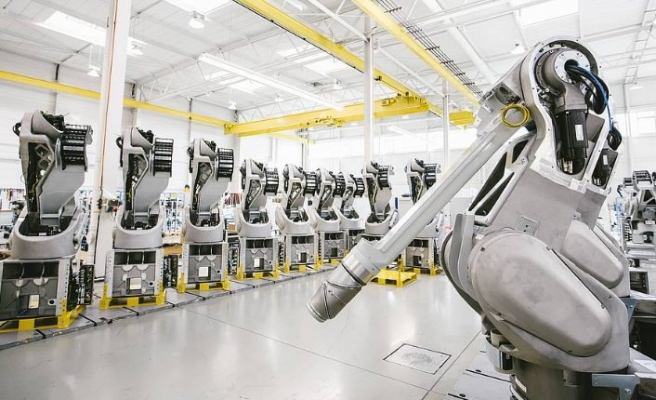

Automated line ?? , Isn't it a bit unrealistic , cause you can manufacture lru in automated machine but making a assembly line will be complicated
Have you seen Turkish production lines? Yes, automation in almost all parts of the industry is valid. Albeit In different degrees. But it is there. Labour costs are not cheap in Turkey. Qualified production line workers may cost over 1000-1500 Euros per month to the employers. This could be higher in engineering side. I remember my company’s cost per worker being 800-1100 euros per month 15-20 years ago. So automation is relevant.
Below is a company that is setting up robotic painting line for Tusas.
Painting a fourth gen jet is quite different from 5 the gen , but I would not comment on its feasibility till I see it real life
Not to mention our co-operation with Germany on industry 4.0 and upcoming 5.G. Will make things faster.
