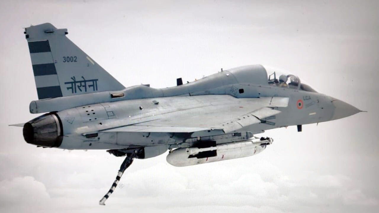

I agree with some of your points, as those are necessary to make Hurjet a CATOBAR carrier based aircraft, i'd also say that Hurjet may require more wing surface area for take-offs and landings.
However, in terms of the requiring a second engine it is not necessary. F-35 runs off a single engine, Harriers have been running off a single engine for decades. It's not a necessity and overall complicates maintenance and would use up space on a carrier. I can see Hurjet becoming India's Naval variant of Tejas, very capable single engined light fighter aircraft.
Well, if you read my post in detail, I have said apart from STOVL aircraft, carrier based aircrafts are twin engined. With the exception of f35C I guess. It is not a necessity. Otherwise there would not be some aircrafts with single engines Operating from carriers. But it is more desirable. Twin engine gives more chance for the plane to survive should there be a problem with one of the engines. For this very reason all carrier based planes apart from STOVL and f35C, are twin engined. The advantages of having a twin engined plane on a carrier must outweigh the cost. Indian Navy has abandoned the Hal Tejas carrier version for this reason.

Yup, if we go for a Tejas variant, it will be TEDBF (twin engine deck based fighter).
It should be about power to weight ratio, if you can make it with one engine you are good.

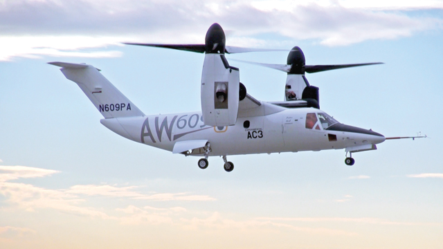

Look at this beauty​
If I were the decision makers in SSB or TN, I would start considering AW609 for the Navy. If Turkey plans to have an Aircraft Carrier similar to Queen Elizabeth-class and considering TCG Anadolu could host VTOL, there is a certain need for a AEW plane like E-2 Hawkeye or Maritime Patrol Aircraft based on ship. AW609 is intended for civilian market but it is evolving into a military tiltrotor as well . Engines are PW Canada PT6C-67A and maker is Italian, so less likely be subject to embargoes. Also P-72 MPAs also made by Leonardo, I would love to see this chopper as MPA or AEW operating from TCG Anadolu. Also think about similar UAVs with TS 1400 turboprop or turboshaft taking off from Anadolu as VTOL aircraft and patrolling..

This American design that is turned into a civilian model by Italians is an old technology which is nowadays evolved into V-280 Valor in its homeland.
The new model achieved a top speed of around 565 km/h.
It is a fast helicopter but lifting capacity and autorotation ability is questionable.
A more reliable single rotor helicopter can be designed in Turkey to match and exceed its capabilities.

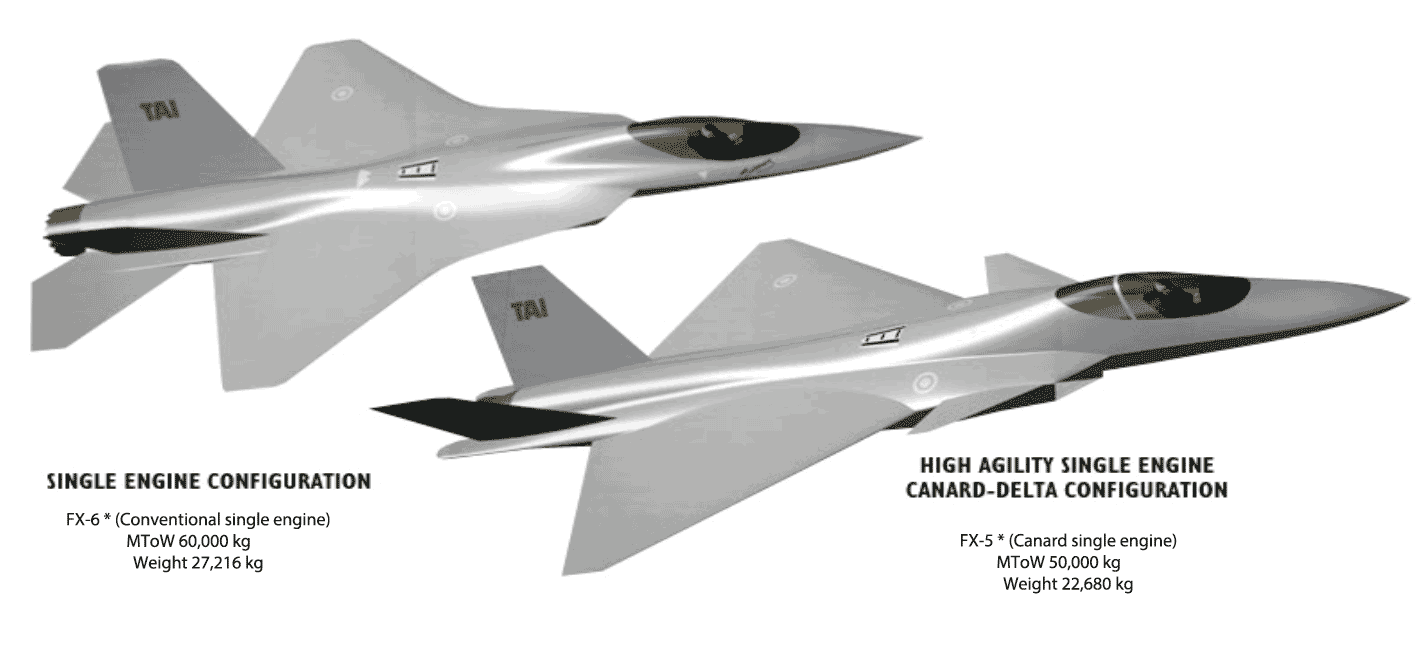

Guys, what do you think about going to one of the previous designs during the feasibility phase of TFX, could one of these designs be envisaged for carrier use?
Canards vs tail wings? Hmm I've no idea . Would it be smart to create new design for limited navalized fighters?
Wait what's wrong with current MMU design? İt has twin engine which suits navalized aircraft.
I would make all of them in addition to the twin engine TFX but not instead of it.
The reason why is there will be in access of 80% commonality, so why not.
Is the current airframe not suitable? As far as I know, the current airframe wing area is more than other pre-designs. It has also more wingspan. In this case, what would be the advantage of changing to a different body instead of configuring the existing body.
There is also a handicap for the navy configurations because aircrafts gets very seriously loads for necessary needs. First of all, landing gear must be stronger, and for this reason heavier and larger. Therefore, every possible kN is needed at take-off. This often causes problems with aircraft fuel and ammunition load. Especially the USA has been spending billions of dollars on pre-mission refueling projects with Carrier-Based aircraft for many years. Last example of this, a huge tanker-UAV program is underway for this issues.
The transition to a different airframe will leave the MMU's main design process largely starting from the very basic, which not only creates problems in both the financial management of the project and workforce planning, but may also be condemned to an open-ended schedule. If a Carrier-Based aircraft project is planning, I think there are two ways to follow. The first is to enter a carrier-based fighter development project as a partner with a foreign country that is preparing a project in this regard. Or we should plan to expand and Navalize the Hurjet first, and to navalize MMU in the long term. Third way is completely ready-end product procurement, but I personally believe that carrying an aircraft dependent on imported logistics on naval platforms greatly reduces the strategic multiplier effect of the aircraft carrier. The model to be followed here must be France's way.

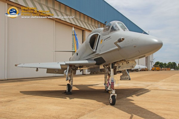

F6U Pirate, F9F Panther, F-9 Cougar, FJ Fury, FJ-2 Fury, FJ-3 Fury, F11 Tiger, F8 Crusader, A7 Corsair II, A4 Skyhawk, FH3 Demon, F4D Skyray. AV8B Harrier all have operated on aircraft carriers with single engines. We shouldn't be so closed off to single engine aircrafts, also, engines have become a lot more reliable over the decades...
Maybe we can grab some modernised A4 Skyhawks from Brazil as an interim solution :)
