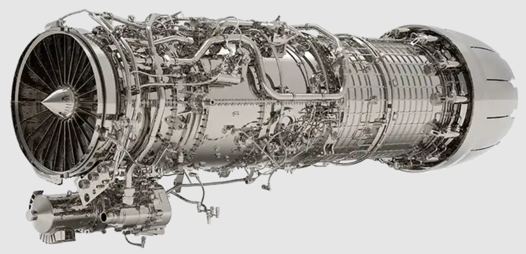

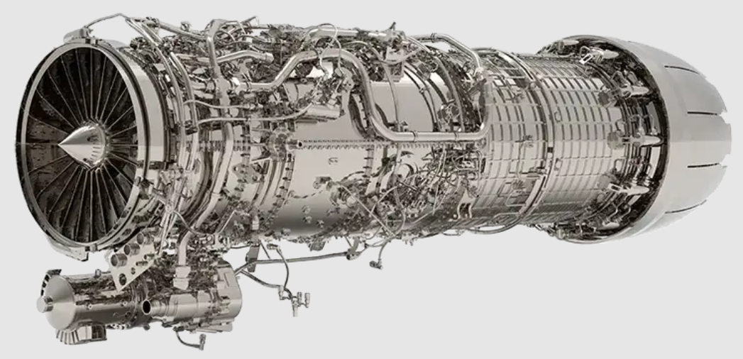

Secondary topics for this thread:
Part 1 - Common Core, TF6000 Engine Family Across MUGEM's Jet Platforms
One dimension of the MUGEM air wing discussion that deserves separate attention is propulsion logistics. Carrier aviation is as much a maintenance and supply chain problem as it is a flying problem. Every distinct engine type aboard a carrier means a separate spare parts inventory, separate tooling, separate technical documentation, and separate training for the maintenance crews. On a ship with finite storage and finite personnel, engine diversity is a cost multiplier.
What makes MUGEM's planned air wing unusual is the degree to which its jet-powered platforms converge on a single gas generator core. As things stand on the current roadmaps of TEI, TUSAŞ, and Baykar:
  • ANKA-3 is confirmed to transition from its Ukrainian AI-25TLT prototype engine to the TEI TF6000 at 6,000 lbf dry thrust.
  • KIZILELMA subsonic variants will receive the TF6000 in the same dry configuration, with deliveries targeted from 2027 or 2028. Supersonic variants will use the TF10000 afterburning derivative at 10,000 lbf, with first afterburner tests planned after that.
  • HÜRJET-X, as proposed in this study, would carry two TF10000 units.
  • The T-925 heavy utility helicopter and T-929 ATAK-II are planned to receive a 3,000 hp class turboshaft derived from the same TF6000 gas generator core, replacing their Ukrainian Motor Sich engines.
The only MUGEM-based platforms outside this family would be the TB3, which uses turboprop propulsion in a different power class, and the T625 GÖKBEY light utulity helicopter with its dedicated TS1400 turboshaft.
If this convergence materialises as planned, the ship's jet engine maintenance shop would work with one core architecture across its entire fast jet and UCAV fleet. Turbine blades, combustor liners, compressor components, and bearing assemblies share commonality across TF6000 and TF10000 variants because the gas generator section is fundamentally the same hardware. Technicians trained on TF6000 core maintenance can service ANKA-3, KIZILELMA, and the core sections of HÜRJET-X's engines with overlapping knowledge. The turboshaft variant for the helicopters shares the same hot section, extending this commonality to the rotary wing.
This carries tangible operational value for a navy establishing carrier aviation for the first time. Training a maintenance workforce from scratch is faster when the curriculum centres on one core engine rather than three or four unrelated types. Spare parts forecasting is simpler. Cannibalisation across platforms, borrowing a serviceable module from one aircraft type to keep another flying, becomes possible in ways it would not be with unrelated engines. None of this eliminates the complexity of carrier maintenance, but it reduces the logistics tail meaningfully.
A caveat is warranted. This commonality exists on roadmaps today. The TF6000 is still maturing, the TF10000 has not yet completed afterburner testing, and the turboshaft derivative is in development. If any of these programmes encounter delays or performance shortfalls, the convergence timeline shifts. The commonality advantage is real but contingent on TEI delivering across all variants within a compressed timeframe. That is a demanding ask for an organisation building its first-generation military turbofan. Furthermore, the TF-35000 project, the main ultimate goal – a top-class main combat jet engine – has been completely excluded from the discussion in this stage.
