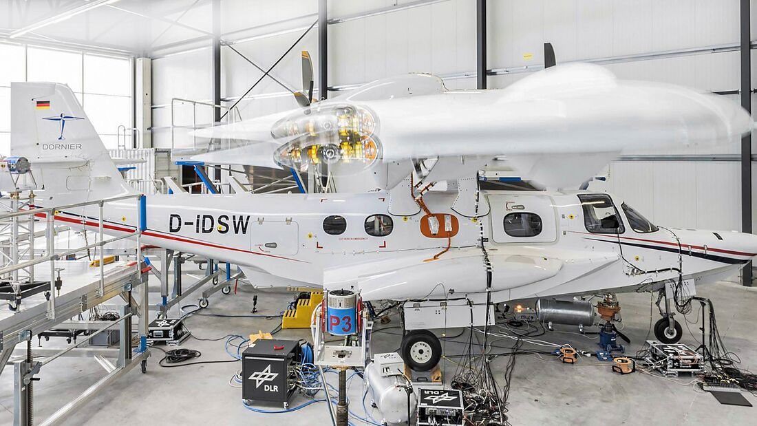

After searching the Web for the Engine I found out something that might help with the Performance Data.
I found a Plane that went into Admission Tests.
"German Aerospace Center (DLR) recently carried out the tests in Oberpfaffenhofen on behalf of Dornier Seawings GmbH, a Sino-German joint venture."
The Test is from 05/19/2021 the Name of the Plane is "Dornier Seastar"
It uses the Identical Engines: PT6A-135.
But all the other Data seems very similiar to AKINCI.
Data Dornier Seastar​
Drive: 2 x Pratt & Whitney Canada PT6A-135A Takeoff
power: 480 kW each (650HP)
Travel power: 370 kW each (500HP)
Length: 12.7 m
Height: 4.73 m
Wingspan: 17.74 m
Wing area : 30.6 m2
Max. Takeoff weight: 5100 kg
Payload: 1300 kg
Max. Range: 1665 km
Max. Cruising speed: 180 knots (333km/h)
Max. Flight altitude: 15000 ft
Compared to BAYKAR AKINCI
That Could give us an Idea.
Length: 12.7 m
Height: 4.73 m
Wingspan: 17.74 m
Wing area : 30.6 m2
Payload: 1300 kg
Max. Range: 1665 km

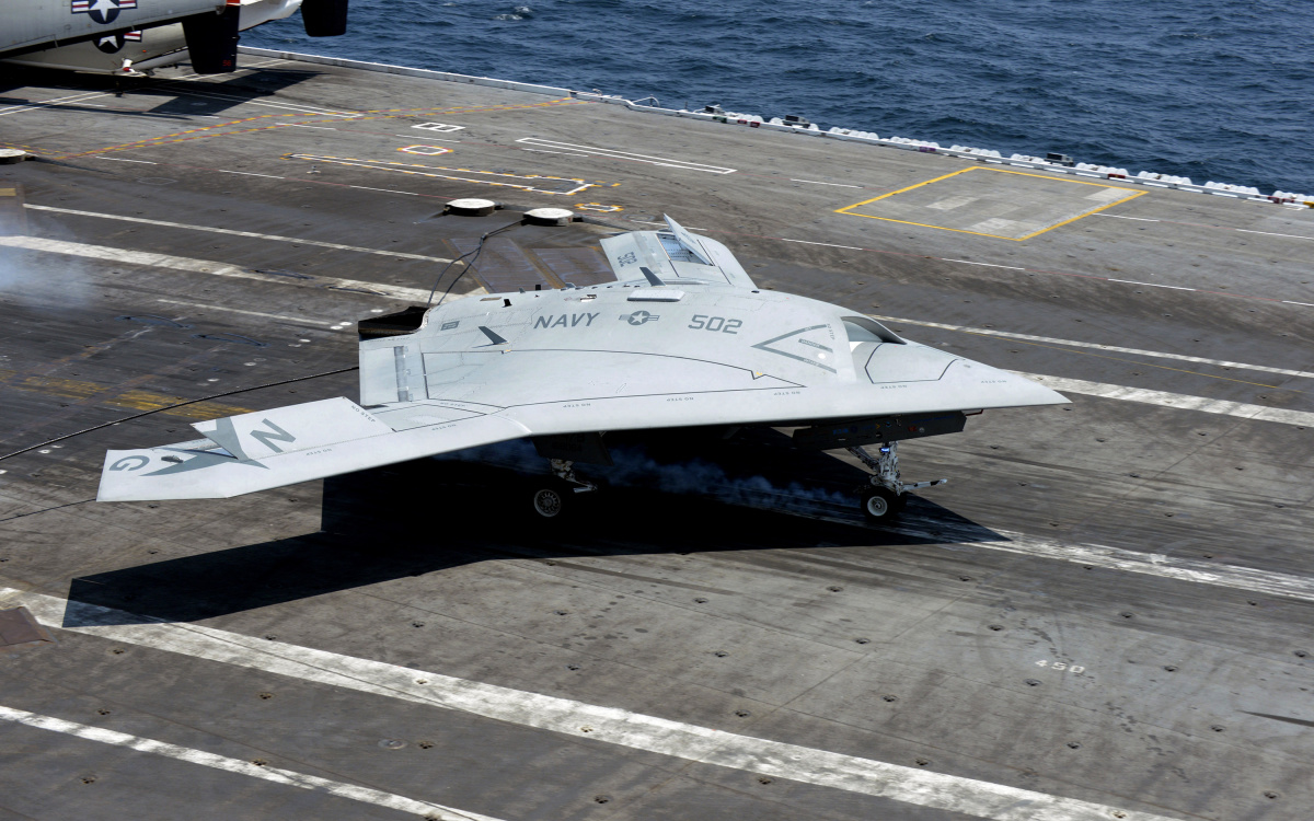

No it's not LOL
It's the first UCAV to ever take off and land from an aircraft carrier. X47B
