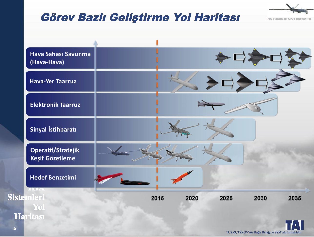

I think there is a big operational advantage to go higher with AWACS planes. If we want IHA-AWACs to operate at 45k feet we need a service ceiling of something like 50-55k feet. AWACS killer long-range A-A and air defense missiles pose an increasingly big threat as those missiles become widespread.
15 8,751
• Air Interception
One of the Anka3 drone's roles is air interception, of actually what? Drones, helicopters, freighters, other slow planes and cruise missiles are a given but can she intercept 4th and 5th generation fighters. I don't see why not owing to its stealth character I would say she is "ambush master #2" against fighter jets.
