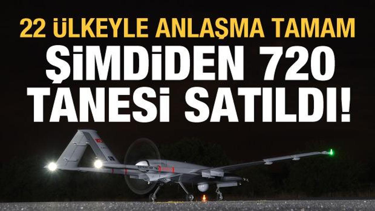

for 3 years they will produce 500 or 400 TB2, total ther are 22 countries who have buyed the drone. They are capable to build 20 TB2 in a month, they are tunning the production line to 30 TB2. They need 3 years to proces the orders. This is a crazy company.....
