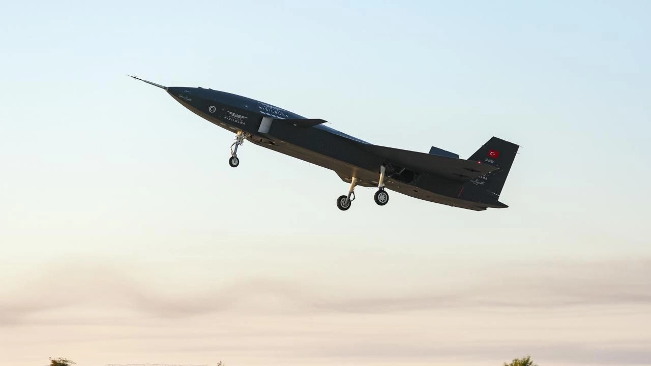

The first two prototypes of Bayraktar KIZILELMA, were powered by the Ivchenko-Progress AI-25TLT engine, 3800lbf.
Seems to be so, in this case we have no clue what the actual number is at this stage. However off the top of my head I remember that the Kızılelma would initially use a 5500 lbf engine and TF6000 would be like 10% higher. I have no clue what happened to that 5500 lbf engine.
Edit: Seems like 5500 lbf is the dry thrust of the AI-222 afterburner engine.
3,715
209 18,998
Exactly one year ago, Kızılelma tested its AI32F afterburner engine with afterburner. But it hasn't flown yet. This engine produces 42KN, or 9244 lbf, of thrust with afterburner. Its dry thrust is 5500 lbf.
4,712
44 16,361
TEI continues testing TF-6000. The test crew gradually increases the working envelope of the engine. I expect it to produce at least %15 more dry thrust compared to a similar Ukrainian engine (Al-222/322) when tested at full rpm due to technological differences between the two. TF-6000 might see a similar maturation process compared to TS-1400. We won't know how it performs until TEI maxes out the engine and releases results.

Kızılelma, tam 1 yıl önce, art-yakıcılı AI32F motoru ile art-yakıcı çalıştırıp test etti. Ama henüz uçmadı. Bu motor art-yakıcı ile 42KN yani 9244lbf itkili bir motor. Kuru itkisi ise 5500lbf.
Hmm, what did KE pt3 and pt4 fly with then? I thought at least pt4 flew and made maneuvers with the AI322F?
3,715
209 18,998
That news is from 2024.
You guys are correct.
That news is from a year ago.
According to below newspiece PT3 has flown with the Afterburner capable engine in late 2024.
Corrected my above post accordingly.
