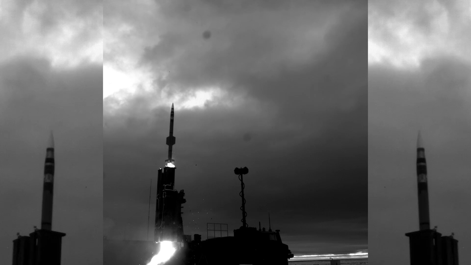

So Siper Block 0/1 made many tests and it is on final phase of tests.

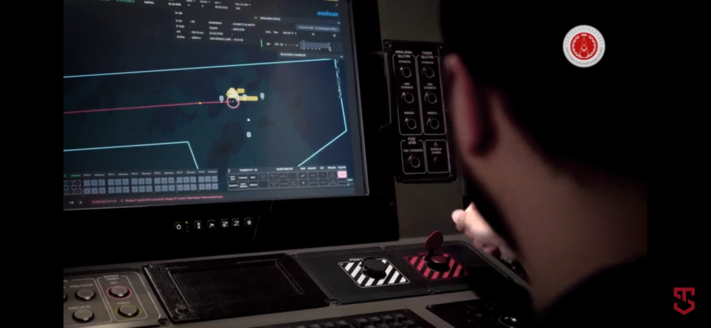

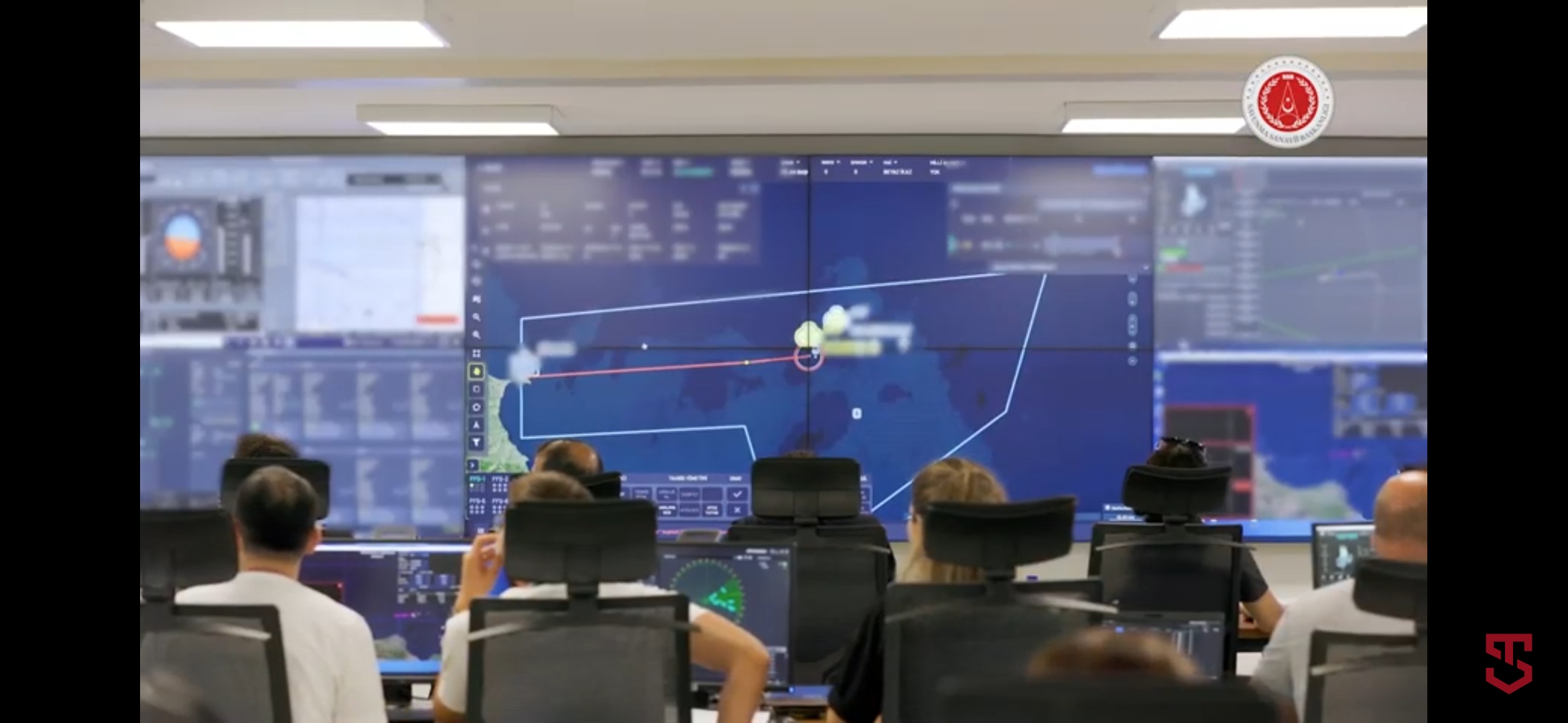

If we look at the data shared in the video, the SİPER Air Defense System hit the target (150 m/s) traveling at a speed of 540 km per hour at an altitude of 8 km from a distance of approximately 93 km (42,0992,36,3205 target coordinate).

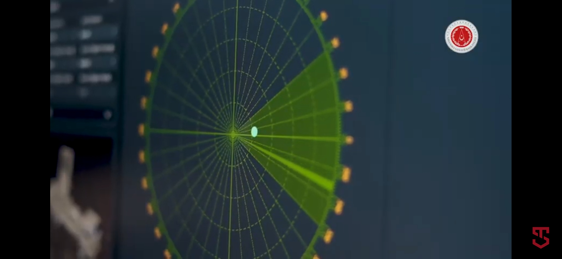

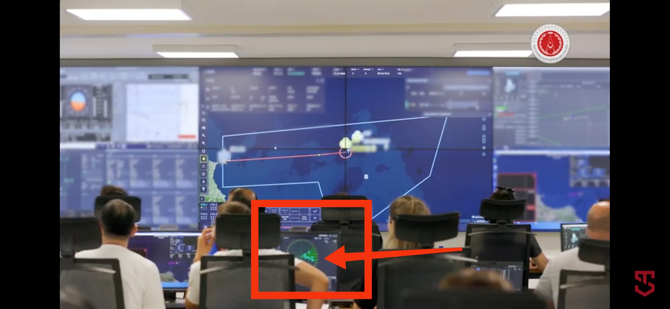

Does anyone has any idea of type 80 drone's radar cross section ?
