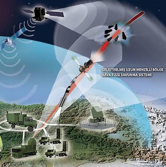

According to infographic, 1 Siper long range SAM battery consist of 4 launcher vehicles that is carrying 6 Siper missiles each. S Band AESA TEIRS radar will be the main early warning element of the Siper structure. We don’t know yet what is the specifications of AKR radar. Most likely, It will be the modified variant of STR (from appearance)

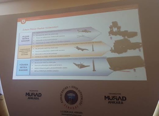

A new radar called AIRS which is going to fill the deficiencies of medium range Kalkan-II (Hisar-O+) and short range MAR (Hisar-A+) radars at low altitudes is being developed by Aselsan. This radar will detect primarily targets flying from low altitudes. This kind of targets mostly remain in blind sector of other radars but AIRS will have a telescobic platform that will raise the radar to increase the sight angle. When AIRS is revealed in 2021/22, It will be operated inside the same network that Siper and Hisar family are operated.
Later, Aselsan will reveal giant radar called YIR. It will have thousands of km range to detect primarily ballistic missiles.
YİR will be the main early warning radar of GUMS (Arrow-3 equivalent) high altitude long range air defence missile program that will be far superior than S-400.

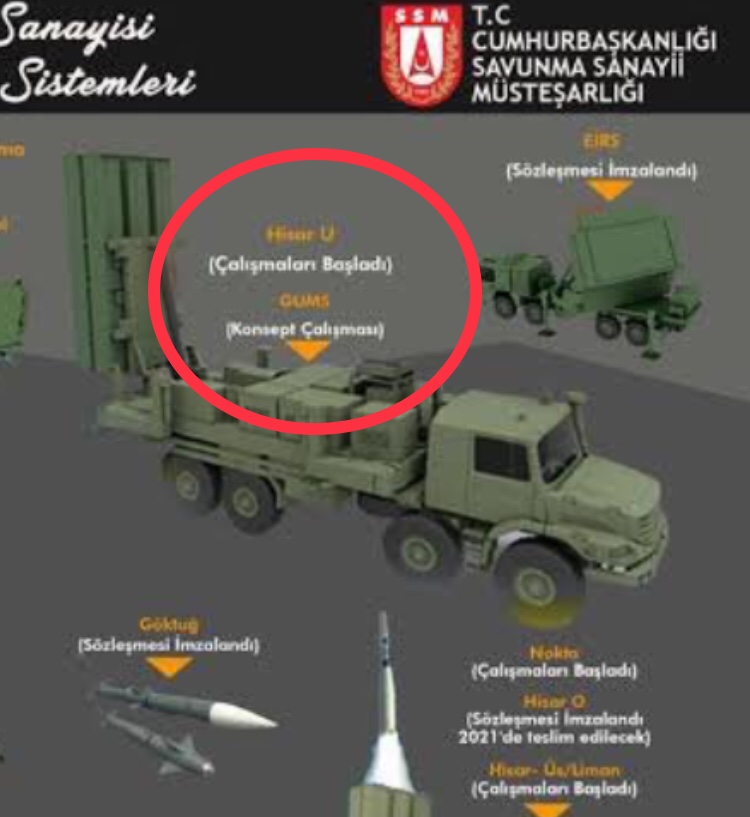

If you check SSB infographic about air defence systems, You can realise that GUMS and Hisar-U(Siper) are two different programs.

76 33,177
These infographics are very old. Many concept changes have been made over those years, and these days have been reached. I think don't be fooled by the visuals.
As part of the announcement dated November 17, 2015 made by the Turkish Ministry of National Defence (MoND) on the cancellation of the T-LoRAMiDS Project, it was underlined that activities for fulfilling the related demands with national resources would be continued. To this end, in 2016, the Presidency of Defence Industries (SSB) launched the Indigenous Long-Range Air Defence System (GUMS/HİSAR-U) Project later named as SİPER. The contract regarding the SİPER Project was signed by an Aselsan, Roketsan and TÜBİTAK SAGE Partnership on January 15, 2018 and within the scope of the Project, being executed with national facilities, Aselsan is responsible for the development of the Long-Range Search Radar, Multi-Functional Fire Control Radar and Radar (RF) Seeker. The system design specifications of the Project were completed in 2018 and the activities on System and Sub-System Design are being executed. With a range over 100km, the SİPER Missile is planned to function against only air breathing targets in the first stage, but Anti-Ballistic Missile capability is expected to be gained during the second stage. The first delivery as part of the Project is aimed to be conducted at the end of 2021.
6 missiles in 4 launchers?? Or you mean 2 missiles on each launcher? Means 8.
In which way?
81 45,473
Even Ibrahim Sünnetçi's articles are out of date.
Agree! The time changes and the programs evolve and many of previous specs including names can change too but SSB kicked off the Siper program with the name Hisar-U, then changed the names as Siper but One thing that was mentioned by official mouths is GUMS was the program that was given to a feasibility study commenced with EuroSam. The feasibility study was aiming to determine the requirements of 3 countries. What Turkey wanted was a SAM with anti-ballistic missile features so Turkey would have purchased a few battery Aster Block-1NT (If Consertium agreed to proceed), later the cooperation would have continued with Aster Block-2 technology for three countries. In this time period, domestic program has already had two names (Siper and Hisar-U).
