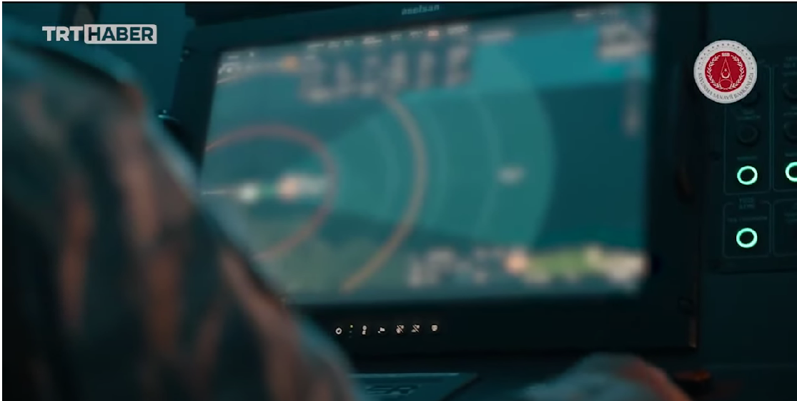

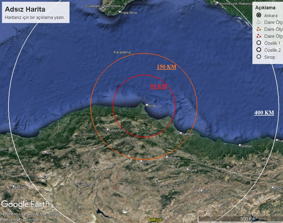

From Last Video
Missile Range : 90 KM
Track & FCS Radar (Possible X Band) : 150 KM
Long Range Search Radar (S Band) : 400 KM
Edit : İt's seen it clearly reach to same level with Samp-t Block 0 . Aster-30 range is already 120 km range but Sampt battery radar arabel range is 100 km so it's generally launch max 100 km from land.

From Last Video
I guess orange circle is for effective range but red is for no escape zone. 150km for an AESA GaN X band radar is too short to believe. I think we can easily say that it has 120-150km effective range. They were using same circle arrangement on Hisar A/O.
Could be against 1m² or 4m² if I had to guesstimate, as @Anmdt (not sure) pointed out before EİRS should have something around 400km for 1m²
150km is good enough for X band FCR.
For example, Çafrad's ÇFR which is GaN based AESA has 150km range with capability to track 1000 targets.
Thales's GaN based APAR block ii (which is used as part of dual band suit) is also has similar specifications.
150km is bad, so bad for such a radar.
5,151
104 10,083
150km against what, in which mode etc etc
Probably against targets with 1m2 RCS.
On a side note- Maybe @Anmdt could tell us why naval X band radars like ÇFR or APAR block ii has limited range (150km) compared S Band radars like UMR or SM400. (450+km)

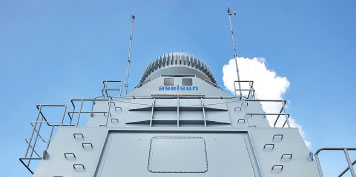

Siper FCR radar is I guess the equivalent of something like MPQ 53 of Patriot, are there any projects going on to build things like TPY-2 Or FPS-129 eventually?

Guys Russian PESA 92N6E (Export variant, Russian variant claims 400km against 1m²) has a range of 250km against 1m² targets. ÇFAKR has GaN front end modules and it's architecture is AESA. 150km is not correct.
Also it is specified as detection, which is a bit blurred
5,151
104 10,083
ERIS has a detection range of 450+km against 1m² targets.
As I pointed out in my previous post, (even though we don't know specifically about ÇFAKR but) Aselsan's ÇFR ( x band element of ÇAFRAD) and Thales APAR ii ( X band element of dual bands suite for naval platforms) both are latest gen GaN based dual Axis AESA and can track up to 1000 targets simultaneously, has a range of 150km. (Officially stated)
So CFAKR having 150km range is not that far-fetched. (And it is not a big issue as it is part of integrated dual bands solution, ERIS+ÇFAKR)
