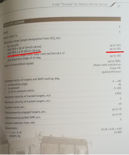

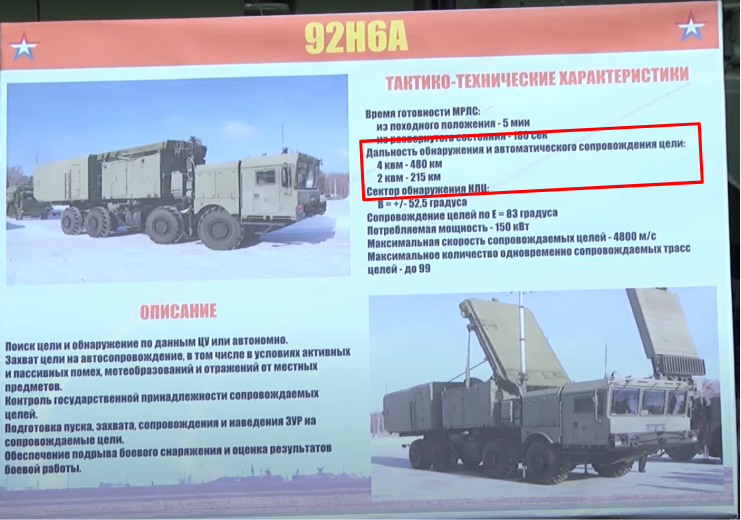

If we take 250km for 2m² into account we still get more than 200kms for 1m². And these are for an older tech radar. "Official" claims are mostly meaningless
Well I agree on that, without context range doesn't tell much, we don't even know if Turkish values are understated or Russian ones are inflated/overstated (various examples of both respectively)
