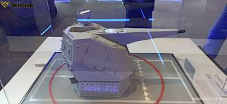

Dear what is your opinion about 30x173mm smart ammunition ?
The ammunition could be used in Turkish warship against Cruise missiles?:
(162x1,24g tungsten subprojectiles could stop?)
"The alternative name of this ammunition is KE-TF. Its a time fused projectile that uses a small explosive charge of 0.5g to eject 162 cylindrical subprojectiles made out of 1.24g of tungsten. The timed fuse is programmed at the muzzle of the gun to explode infront of the target and shower it in subprojectiles. It flies at 1075 m/s just like the HEI-T"
This turret weights just 2.5 tons
Here is the 35mm smart ammunition:
"Each round disperses 152 small tungsten projectiles weighing 3.3 grams (0.12 oz) each to form a lethal cone-shaped cloud to strike the incoming target."
But it weights 4.5 ton.
Look even single burrel Göker how bulky is.
Wouldn't be great 30*173mm Göker for our frigates?

So what? Do you think i didn't know?
Then what is the point of proposing Goker for frigates when it already has Gokdeniz?
Edit-
instead of 35mm , 30mm Göker wouldn't be more compact as well as effective?
Did they develop 30mm version of Göker yet?

idk man, looks like vaporware to me
Wait until the air show starts. (Let’s see what product they unveil) Even without that, current David's sling should be quite capable against Russian/Iranian 'hypersonic' weapons.
Edit-
The point is göker can be used on both side of ship so it can be fired at the same time on both sides,so the ship become more resistant to multible attacks,the other point is göker canbe used at more fire angle than gökdeniz this also gives immunity to high angle attacks.If the fire rate of 500/dk is enough double göker is better than single gökdeniz
Current Gökdeniz even Göker systems are heavy and bulky. They engage too much space on the ship.
Imagine as if Göker used 30x173cal smart ammunition, the gun system would be lighter and more compact.
Again imagine as if Istif Class Frigates had:
Port and starboard: 2 X 30mm Göker
FORE and AFT : 2 X LEVENT
And 8 cell VLS

35mm ATOM/AHEAD type munitions are already too small to be effective against some threats, which is why we are still putting Phalanx on new ships. If anything we should move to 40mm ATOM or larger.

@Yasar instead of 35mm , 30mm Göker wouldn't be more compact as well as effective?
If 30mm hits the target from 3km away, 35mm hits from 4km and with supersonic antiship missiles(even hypersonic) thats very important.
Also, i believe Goker has higher(around 90 degree) elevation that Gokdeniz doesnt have because of design differences. That 90 degree is important for cruise missiles that goes to top attack mode at the end.

He says its bulky, of course its bulky, you store more than 35mm ammunition inside, the more you have, longer you are safe as reloading it means you are defenseless. Thats the only advantage of 30mm, but we talk about a ship that has enough space
Compact? Yes.
Effective? No.
Anything less than 35mm for air burst is not going to cut it. I would rather go for a 40mm air burst round for a ship’s CIWS.
With supersonic and even hypersonic missiles becoming more widespread, it is important to intercept these missiles as far away from the ship as possible. A CIWS like Phalanx that has electronics that engages a missile at 2500m, can actually effectively hit that missile under 1500m. If there is a second target to engage as well, then even if it hits it, most of the debris carrying enough kinetic energy will damage the ship extensively. A Brahmos travelling at around 2.4mach at terminal stage has under 2 seconds to hit the ship at 1500 metres. This is a 3 ton missile. OK it will be lighter at terminal stage having expended most of its fuel. But will still have a lot of mass travelling at that speed.
Gokdeniz will form a steel wall at a distance of 4000m from the ship. Theoretically it should stop multiple targets coming in with no danger of fallout or collateral damage.
We do have Atom 40mm airburst round and Şahin (Hawk) system to use them with, but their range is extremely limited. I hope Aselsan is working on a longer range versions not just naval air defense but as an overall option.
