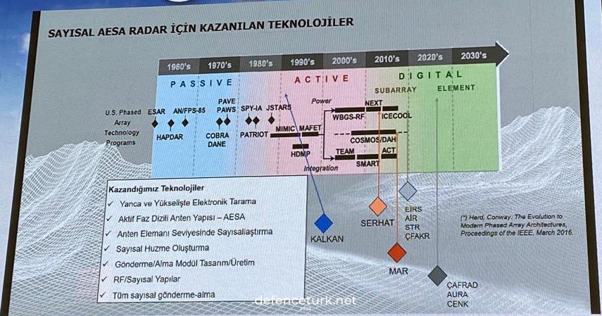

Can you please translate the relevant part?
Tbh not much to be translated, and not much to be seen but they placed Kalkan under Active part, idk if that is a graphical error
