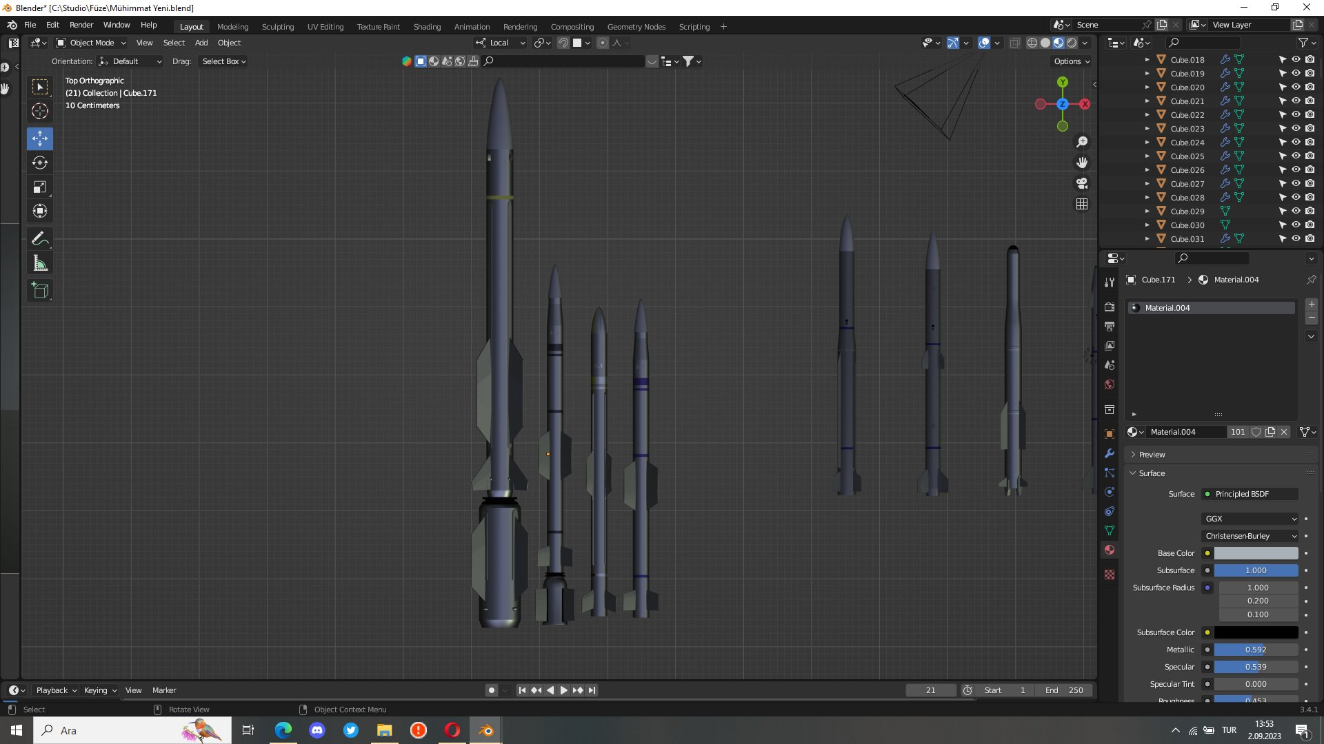

TÜBİTAK SAGE General Manager Gürcan Okumuş: "SİPER Blok 2's range can be multiplied by 1.5 to 2 times with a booster"
So our dreams of a SİPER Block 2ER are likely to come true
So, this thing will probably be nearly 8 m in length. Mk41 Strike Length measures at nearly 8 m and SM-6 fills nearly the entire length.
