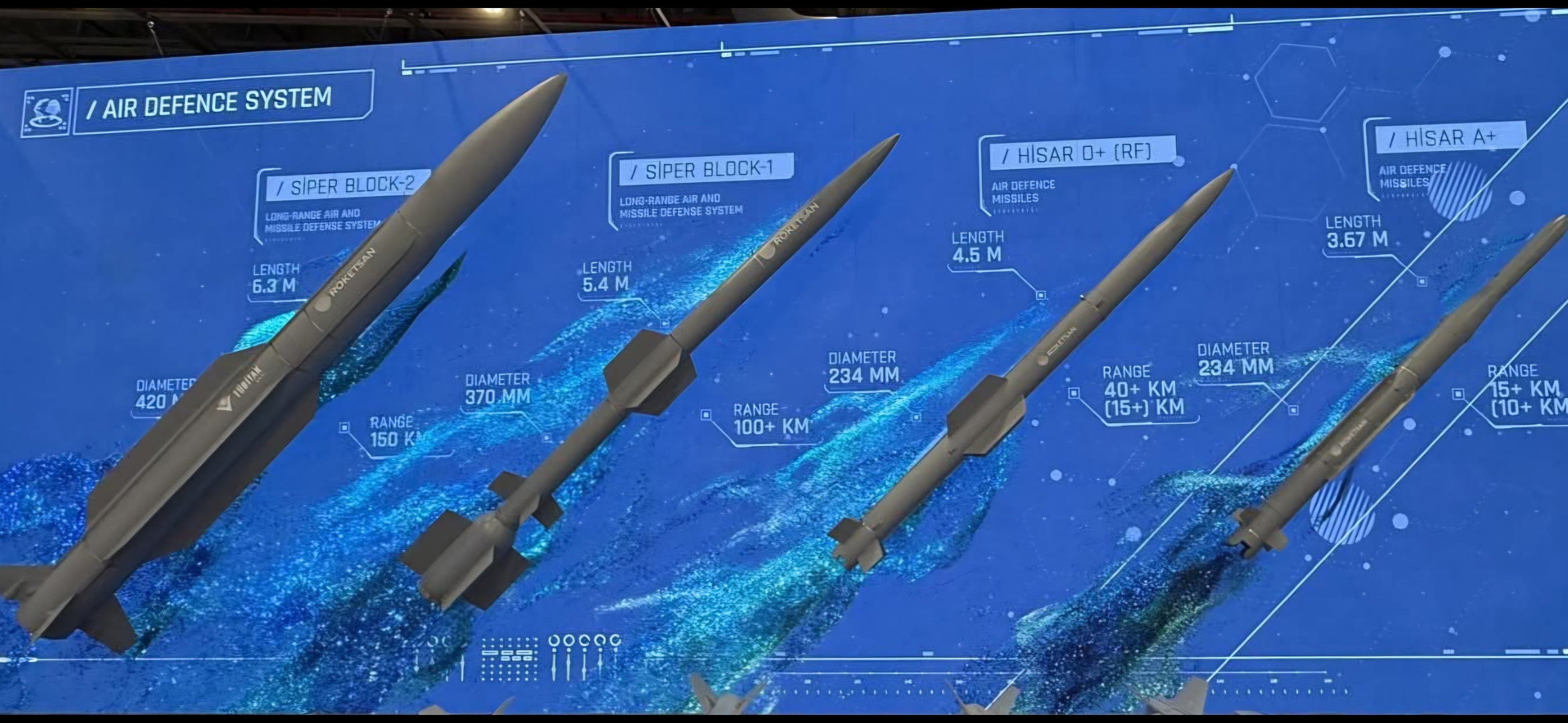

Hisar A+ ( 15 km range and 10km altitude ) with that range is useless just use Sungur instead and produce more Hisar O+ / Siper .
Any news about more tests of Siper 2 ? Can we expect first half 2026 to be active service ?
Useless? Air defence doesn't just target planes, it can target drones, cruise missiles or ballistic missiles. There is a reason we call it a layered approach. It is all part of the air defence umbrella, and you can't have soldiers scanning the skies with a Sungur on their shoulders waiting to see a threat coming in.

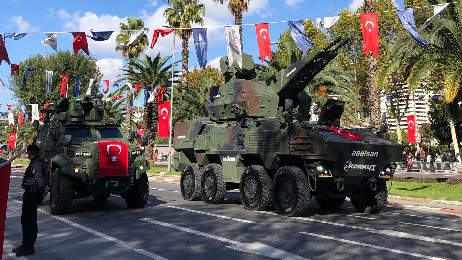

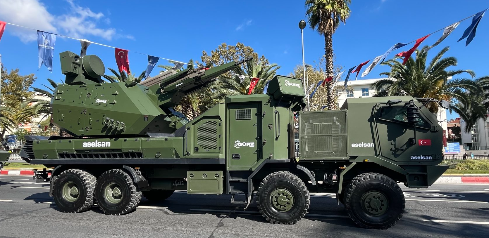

Hisar-A should be axed. All Hisar-As should be replaced by Hisar-Os. Short-range (<15km) air defense solution should be mainly based on Aselsan Gürz or a similar system.35mm autocannon, Sungur, Levent and semi-active RF Guided cost-effective missile should be the main effectors of the system. The longest range air defense missile of the system should have 15km range. Sensor package should include 4x AESA radars(360 degree coverage) that has at least 2x the range of the longest range missile (30-35km), EO system, self protection sensors (LWR, RWR), acoustic sensor, 360 degree situational awareness system, and ESM/jammer. Missiles should be inherently mass producible in the thousands. The system should carry 16 missiles. Hisar-A IIR missile as well as Bozdoğan WVR missile shouldn't be a part of this structure. Bozdoğan should be a part of Gökdemir (national NASAMs) architecture.

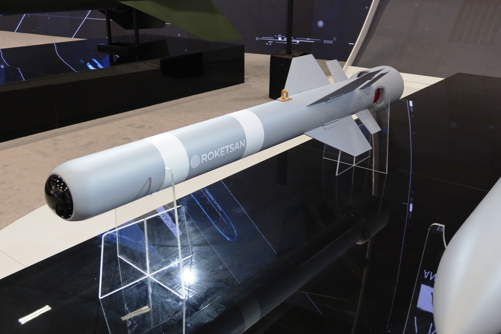

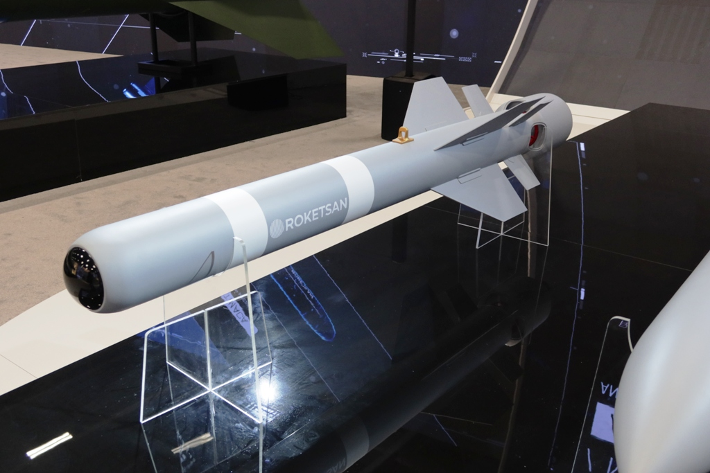

Defense Industry President Prof. Dr. Haluk Görgün;
“The HİSAR-A system, one of the critical components of ÇELİKKUBBE within our layered air defense architecture, has successfully completed its acceptance firing using elements from the serial production line. In the firing conducted via the Missile Launch System (FFS) against a high-speed target detected and tracked by the Fire Control Device (AİC), full engagement was achieved with the HİSAR-A missile featuring an IIR seeker head, and the target was neutralized. With this firing, the new-generation HİSAR FFS configuration and the serial production batch consisting of HİSAR-A missiles with seeker heads have become mission-ready. With its advanced sensor, guidance, and engagement capabilities, HİSAR-A continues to serve as one of the foundational elements forming the backbone of our low-altitude air defense and strengthening the on-the-ground deterrence of ÇELİKKUBBE. I wholeheartedly congratulate the ASELSAN and ROKETSAN teams who contributed to this significant achievement, our Ministry of National Defense, and the esteemed personnel of our Land Forces Command. This firing is a resolute signature cast into the skies of the Sky Homeland, a silent yet powerful expression of our national engineering prowess. We continue to advance with confident steps in the Sky Homeland.”
