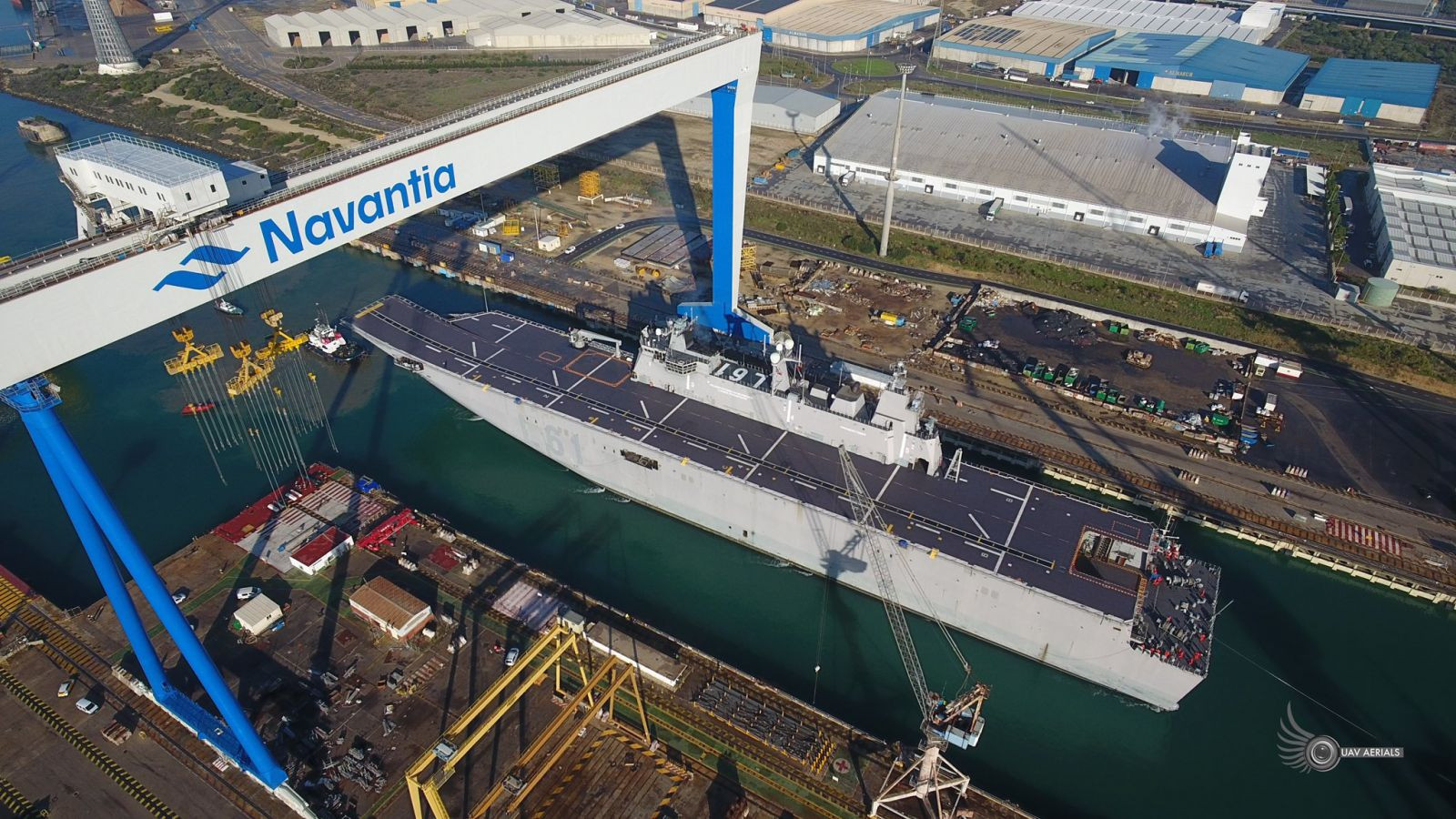

what kinds of planes will operate this carrier after the f35 crisis with the usa ? except the herlicopters of course and uavs
It is an LHD additionally modified to host STOVL aircraft. Without it, it is still a fully functional LHD.
At least it won't have any issues in the future when another STOVL aircraft is introduced or issue with US has been resolved. The ship is expected to be operated for 30+ years.
As it stands I can’t see it operating any planes in the short term.
To take the ski lift off the design when building the ship was going to be more expensive than leaving it. So probably because of this it was left. But during the building of the ship f35 idea materialised and the surface of the deck of the ship, with great expense, was covered with a special material to withstand the extreme heat the F135 engine generates especially when vertical landing. That now stands as wasted money.
But I believe that with the right modifications, the ship can still accommodate a complement of 6 to 8 planes, like Navalised Hurjet, if powerful engines are used and a good arresting hook is fitted. But as we never have had any experience in this area there is too much to learn yet. So don’t hold your breath! (Then again we did not know enough about UAV technology apart from operating some Herons that did not work properly)
The reason why Spanish design was chosen is presence of the ski-jump. The ski-jump was also present in Request for Proposal, thus it was planned. However project itself has changed remarkably over time, the decisions were made prior to the construction in RfP. Same applies to jet-resistant deck, it hasn't been decided later but before the construction.
Not possible. Explained it in earlier pages i believe. 1st of all, the ship is an LHD, we can't add a catapult and arrest system which would penetrate the deck, down to hangar, for large planes. There could be some innovative solutions for medium size UAVs but will not be long term.
