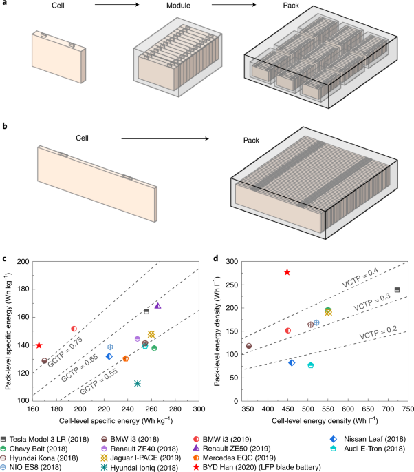

Thermally Modulated Lithium Iron Phosphate Batteries
This is a new battery technology being developed. 10 minute charge, no adverse effects of li-ion or li-hydride or li-polymer batteries. Much cheaper longer life (expected to last 2 million miles). It does not catch fire. And most importantly much lighter. Still in development stage. But a solution to current shortcomings of rechargeable batteries.
Then there is Tesla’s 4680 Battery. This is a revolution in it self.
So the Technology is there to use. It is up to us if we want to get on the band wagon or not!
We should definitely try a hybrid electrodiesel power train for our tanks at this time.
