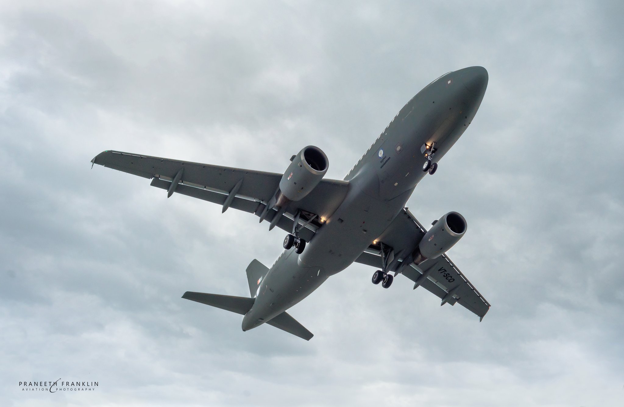

Looks like work on the DAS prototype has begun...
The proof of concept for the sensor fusion software looks like it'll only have 2 sensors to begin with. The system would probably be integrated on the DRDO A319 FTB first...
E64xQ09UcAQ7jT8.jpg:large
