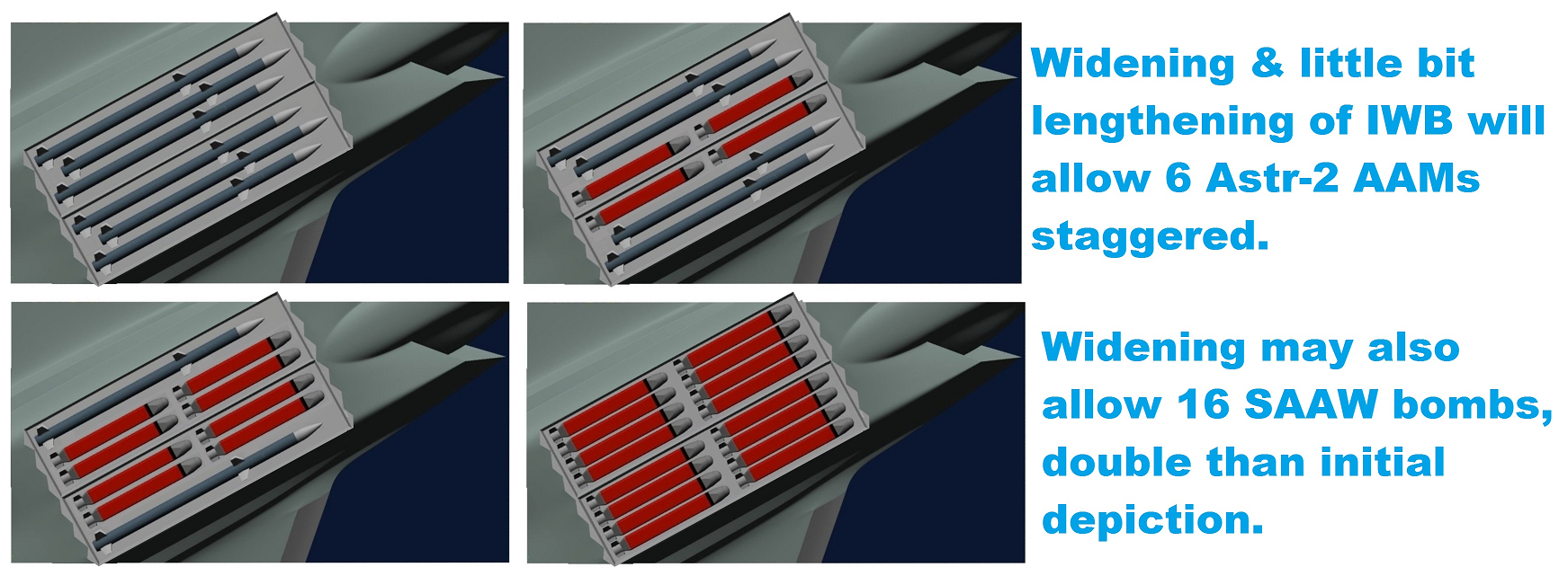

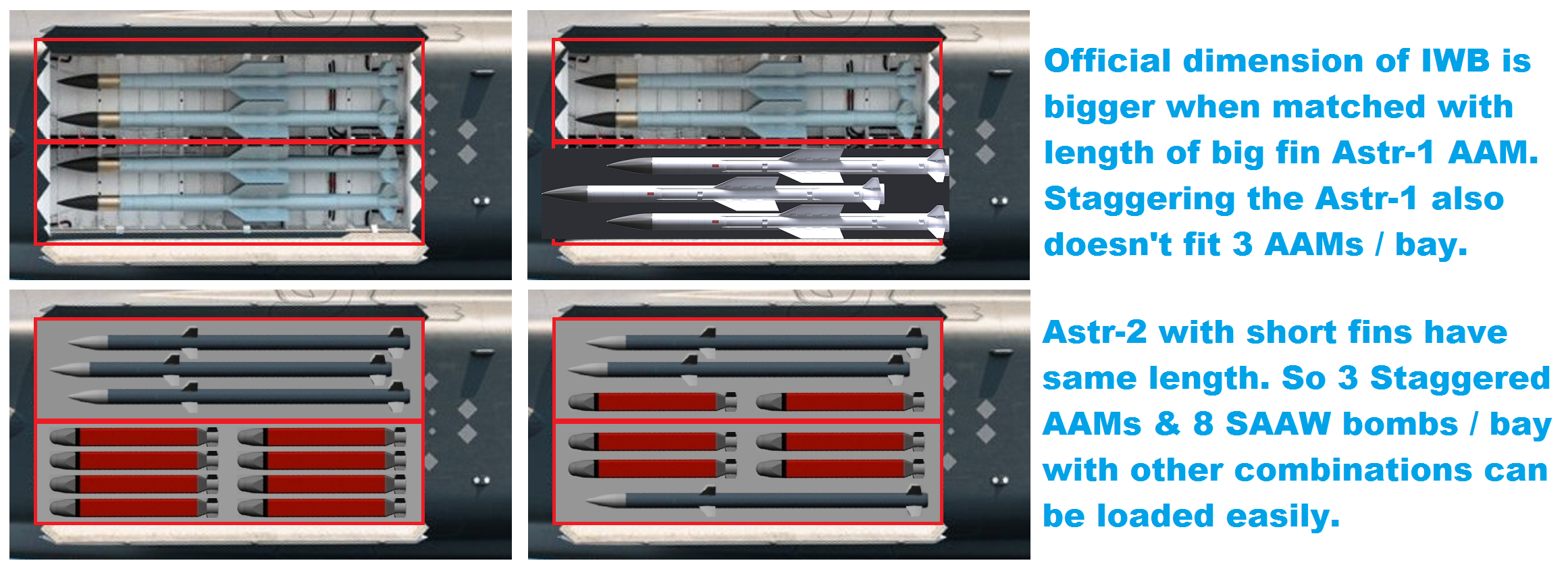

If AMCA's IWB can be widened & Astr-2 AAMs staggered then similar to F-22, 6 Astr-2 AAMs can fit.
In A-G only mode, it may allow total 16 SAAW bombs.
In persuit of improvements, there might be some good news. 🥳🤟🥁🎯🎊🎉
The unofficial tweet might be true. I lately got an infographic showing AMCA's IWB dimensions to be 4.2m long, 2.2m wide, 0.75m height. The dimension is not mentioned in many other posters.
The Astr-1,2,3 AAMs have same length 3.84m. But unfortunately due to big fins of Astr-1, even staggering doesn't help to fit 3 AAMs/bay, total of 6.
But the Astr-2 with shorter fins can easily fit with staggering.
Bcoz of limited info coming out gradually, the older CADs couldn't show the actual weapons capacity. If we superimpose the actual IWB dimensions to match with Astr-1,2 AAMs then we can see the difference.
In latest CAD by artist Kuntal Biswas who sticks to official specs, the IWB seems to have been widened, although a bottom view with exact dimensions & capacity is not available yet. The below pic is 2.5 months old now but nobody posted.

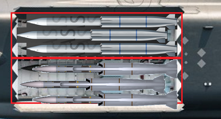

More good news to come gradually. 🤟✌️🎯

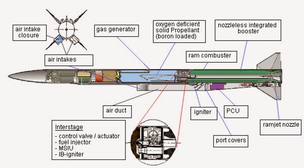

Fitting Ramjet missiles is a challenge bcoz of their long intakes, it becomes difficult to stagger them.

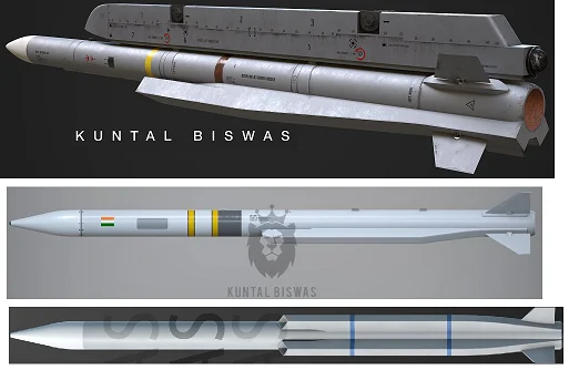

There is an early render by artist Kuntal Biswas of 2 Astr-3 SFDR /bay, total 4 AAMs, but pic is angled, the bay is short with big gap in between.
He has also made multiple CADs of Astr-3 SFDR BUT with different fin & ramjet intake dimensions.
The 3rd one is the only one with bottom view so if we resize it with IWB then still it will be a TIGHT UNSAFE fit of 3 staggered AAMs/bay.
And if we consider 3 staggered Meteors (AAM CAD by artist "AkelaFreedom") then although it is 6" shorter but its intakes & fins seem to be wider & overflows out of bay.

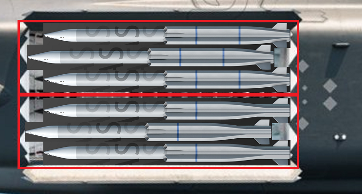

If the Ramjet intake is shortened then 6 Astr-3 SFDR AAMs might fit relatively better. But there could be military safety specs which may or may not allow this.

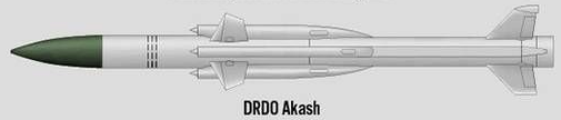

We see Akash-1 SAM also has Ramjets which don't extend all the way backwards.
The intake fairing in Meteor is long bcoz it houses some electronics, fin actuators. Same could be with Astr-3 SFDR. But if the AAM body can be adjusted then it can favor AMCA.
Low IQ Techie
109
17 132

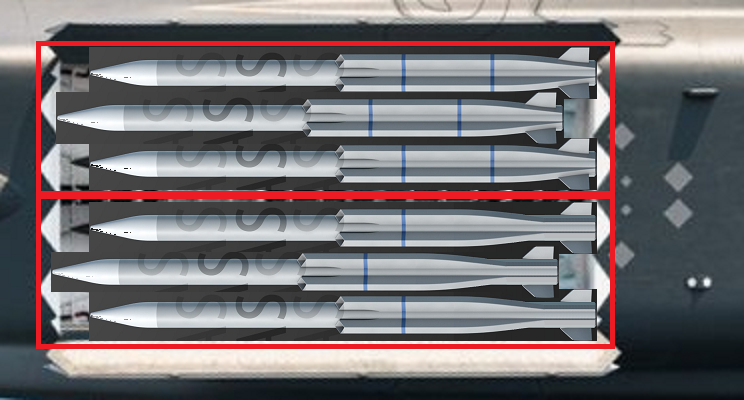

Continuing on this agenda of internal load, 2 days back someone shared PL-15E AAM with folding fins from Zhuai airshow. AFAIK big/heavy missile do have folding fins but a medium missile is yet to be seen with AIM-120 AMRAAM, Meteor, etc. R-77 have folding grid fins.
Now there is no CAD of Meteor, Astr-3 SFDR with folding fins & i can't use PL-15E to depict in AMCA.
So i'm just clipping the fins in SFDR pic. IDK the safety gap spec but this looks like a safe fit, that too w/o staggering.
And i had already shown that 6 staggered AAMs of short fin version of Astr-2 could easily fit. So if we use folding fin version of it now then total 8 staggered AAMs or 16 SAAW bombs could fit. The ejectors shoud be firm & free from vibrations.
If this config is considered unsafe then in worst case 6 AAMs or 12 SAAW bombs can fit easily.

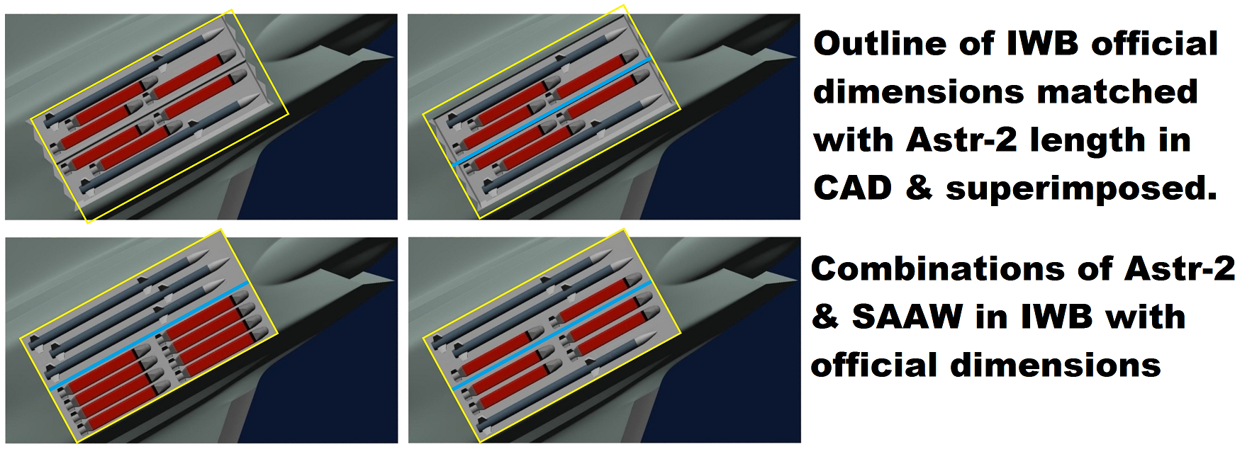

Continuing the chain of posts for weapons in AMCA's IWB which is officially quoted 4.2m X 2.2m,
After observing the designs of all BVR-AAMs made globally, and intention of F-35 & J-35 to increase their IWB capacity to 6 AAMs, I had shown by diagrams that only 4 big-fin Astr-1/2 AAMs can fit in IWB but,
6 staggered Astr-2 short-fin AAMs (like AIM-120-D in F-22),
or 6 modified Astr-3 SFDR,
or 8 folding-fin Astr-2 AAMs can fit in (like Chinese PL-15).
I took the CAD of Astr-2 big-fin by artist "Akela freedom" & edited in Paint to match short-fin version made by artist "Kuntal Biswas" which is also identical to AIM-120-D. So the forward fixed fin has been shortened & shifted forward & rear fin leading edge more swept back, that's all, simple quick edit.
Now we can see the comparison more clear & precise, 4 & 6 big-fin AAMs vs 6 short-fin AAMs in the outine of official dimension of IWB. Unfortunately an updated CAD is not released yet by any artist or DoD.
I did this few weeks back but I waited for Aero-India, hoping they would officially increase the IWB capacity & showcase, but didn't happen. But this is not an up-hill task & can be done easily till IOC jet.
There is no separator wall in the IWB. 1 door panel slightly overlaps on the panel of other side door, means both doors have to open full to drop any weapon, exposing full IWB.
I hope this gets corrected in IOC jet.
