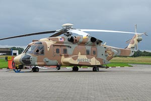

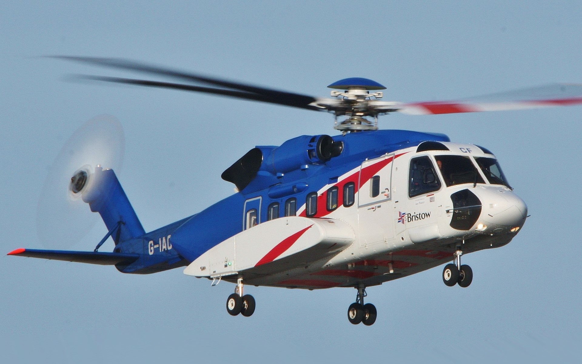

However that still does not solve our dilemma for the T-929 engine. Our only short term solution is to licence produce T700 engine by improving power output to suit our helicopter. This engine, in it’s CT7 format can yield a shaft power of up to 3000HP as used in Superhawk helicopters. Whether GE would let licence production of that engine be available , is another question though.
Superhawk S92

However that still does not solve our dilemma for the T-929 engine. Our only short term solution is to licence produce T700 engine by improving power output to suit our helicopter. This engine, in it’s CT7 format can yield a shaft power of up to 3000HP as used in Superhawk helicopters. Whether GE would let licence production of that engine be, is another question though.
Superhawk S92
