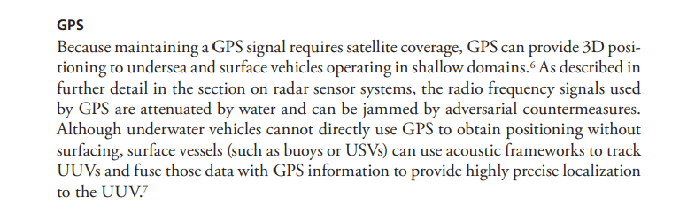

It can't. There isn't any technology that can. Which is the main reason their use is very popular these days. Moreover, unlike a large UAV, an underwater glider is cheap enough to be disposable.
And how will our fisherman hunting down something that they can't even see or detect? Although having commercial fish finder can certainly help, it still takes a serious amount of training to use them. Considering that the vast majority of our traditional fisherman (small boats) doesn't even have carried any compass with them. Although most of them do carry android phone that do have compass & GPS, unfortunately even among the highly educated Indonesian in major cities, rarely do I found anyone who knew how to their phone compass or GPS, let alone know how to read any navigational chart.
Not really
It still can be tracked/jammed through its GPS signal and by using acoustic frameworks
The WHAT....? All RNSS receiver are passive (receiver). And how would you intend to track something by jamming them..???
Those are very weak mechanical transient in high band there. It will be lucky enough to even pick it up beyond 1 -2 nm radius in ideal condition. It's not like those gliders emit anything in the lower band either (50 hz or 60 hz )
The point is not detecting them but preventing them from getting a GPS fix and leading to inactivation.
I told earlier, gliders inactivate themselves if they can't transmit data, get a GPS fix, or stay motionless: either floats or sinks. Without a GPS fix and uncalibrated INS, the later collected data has no value or meaning.
I'm aware of that, however the whole notion of tracking something that is only passively receiving (any GNSS receiver) is no-brainer to start with. Unfortunately such notion seem to be very prominent these days due to most people mistook GPS = Google Map service.
Again it needs reverse engineering to find out which satellites it uses for communication. It could get hard if they are equipped with commercial and non-chinese systems which will be a dead end.
If I were the ChiCom I connect them to either Inmarsat or Iridium and subscribing the account from some shell company.
