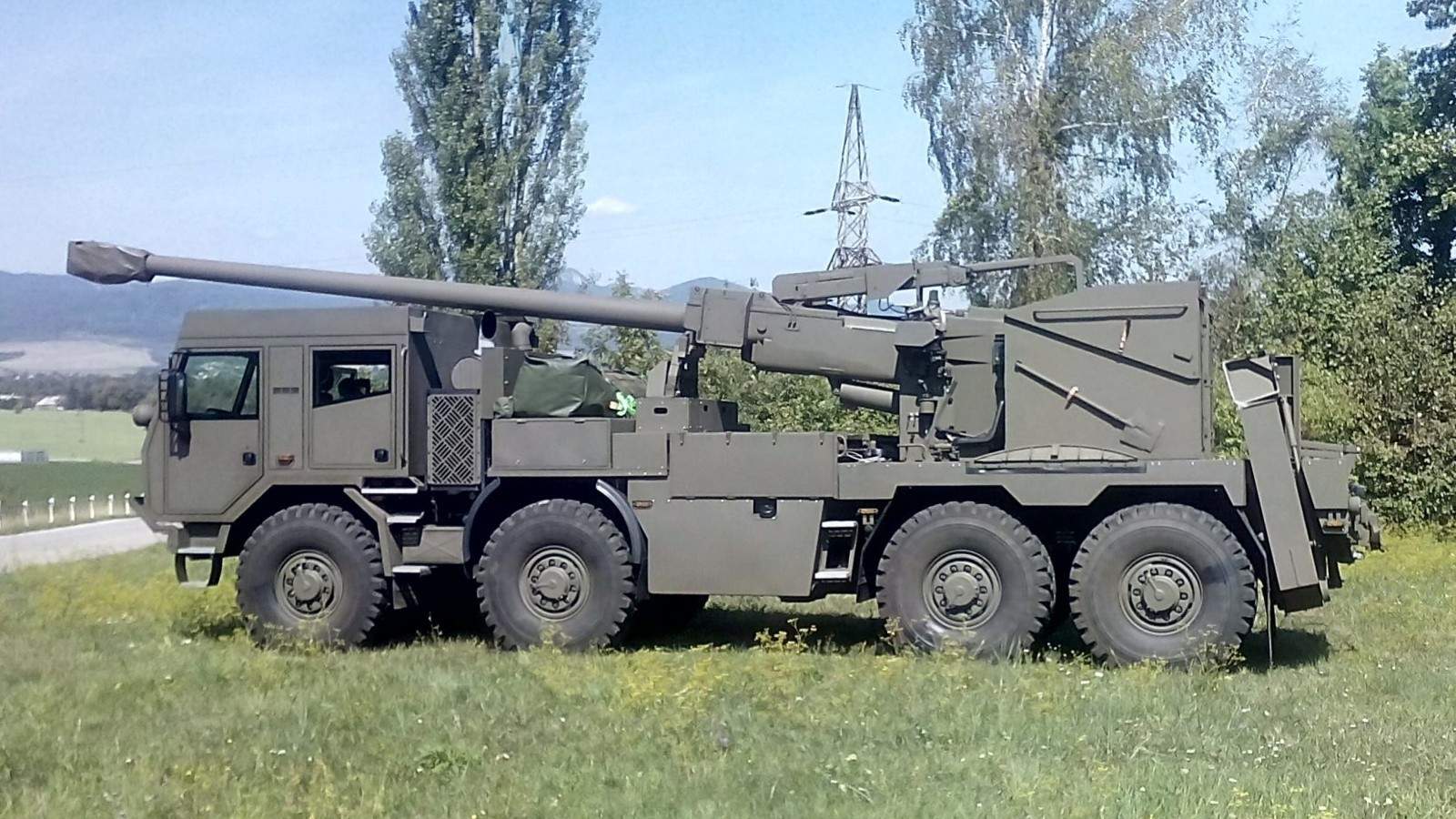

well, if EVA going to be next marine SPH, surely their "kepala batu" already gone. since the first time marine insist, the SPH operators should be protected in cabin/turret, like zuzana.

this one have shorter barrel length compared to EVA TMG and Zusana 2, 45 cal vs 52 cal.
i guess stick with the 52 cal barrel option since caesar have the same barrel length, assuming it could actually use the same munition and propellant (compatibility reason).

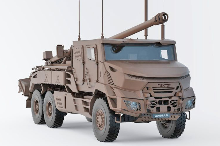

If Marine requirement for armored cabin is true, there's 6x6 Caesar New Generation variant with armored cabin & fully automatic reloading system, same as Eva. This variant was ordered by Belgian army.
https://www.joint-forces.com/defenc...belgian-purchase-of-caesar-new-generation-sph
And it's already in indomiliter https://www.indomiliter.com/nexter-systems-kembangkan-caesar-6x6-mark-ii-next-generation/
if they satisfied by the current caesar, caesar NG would be a good choice....
but if they wanted something more, such as more ammo storage, capabilities and ext, the Morana can do a direct fire, also the gun, ammo and stuff are more protected since it basically a turret, less trouble when finding or adjusting the cannon for a good firing position...
