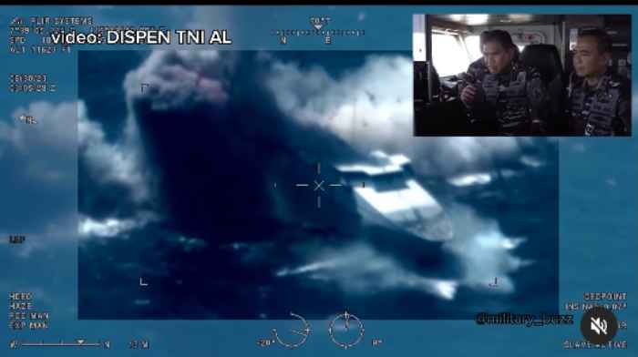

TNI AL Develops "Kamikaze Drone" as Mainstay Weapon
This was expressed by KSAL Ali when reviewing the IT Exhibition of the final seminar for student officers (Pasis) regular education (Dikreg) of the 61st batch of the Indonesian Navy Command and Staff College in 2023 at the Yos Soedarso Building Auditorium, Seskoal Command Headquarters (Mako), Kebayoran Lama, Jakarta South, Monday (23/10/2023).
"In this final seminar, there was an extraordinary thing built by the 61st Force of Pasis Dikreg Seskoal, namely they created a kamikaze drone. "This Kamikaze maritime drone can later be utilized and its capabilities developed to be used as one of the mainstay weapons for the Indonesian Navy," said Ali in a press release from the Indonesian Navy's Information Service (Dispenal), Tuesday (24/10/2023).
Dispenal's press release stated that the kamikaze drone is a multi-purpose drone that can be used as an auxiliary element for coastal patrols at TNI AL Posts (Posal) and TNI AL Bases (Lanal).
Kamikaze drones can be used as target fire in aerial and anti-drone strike drills.
